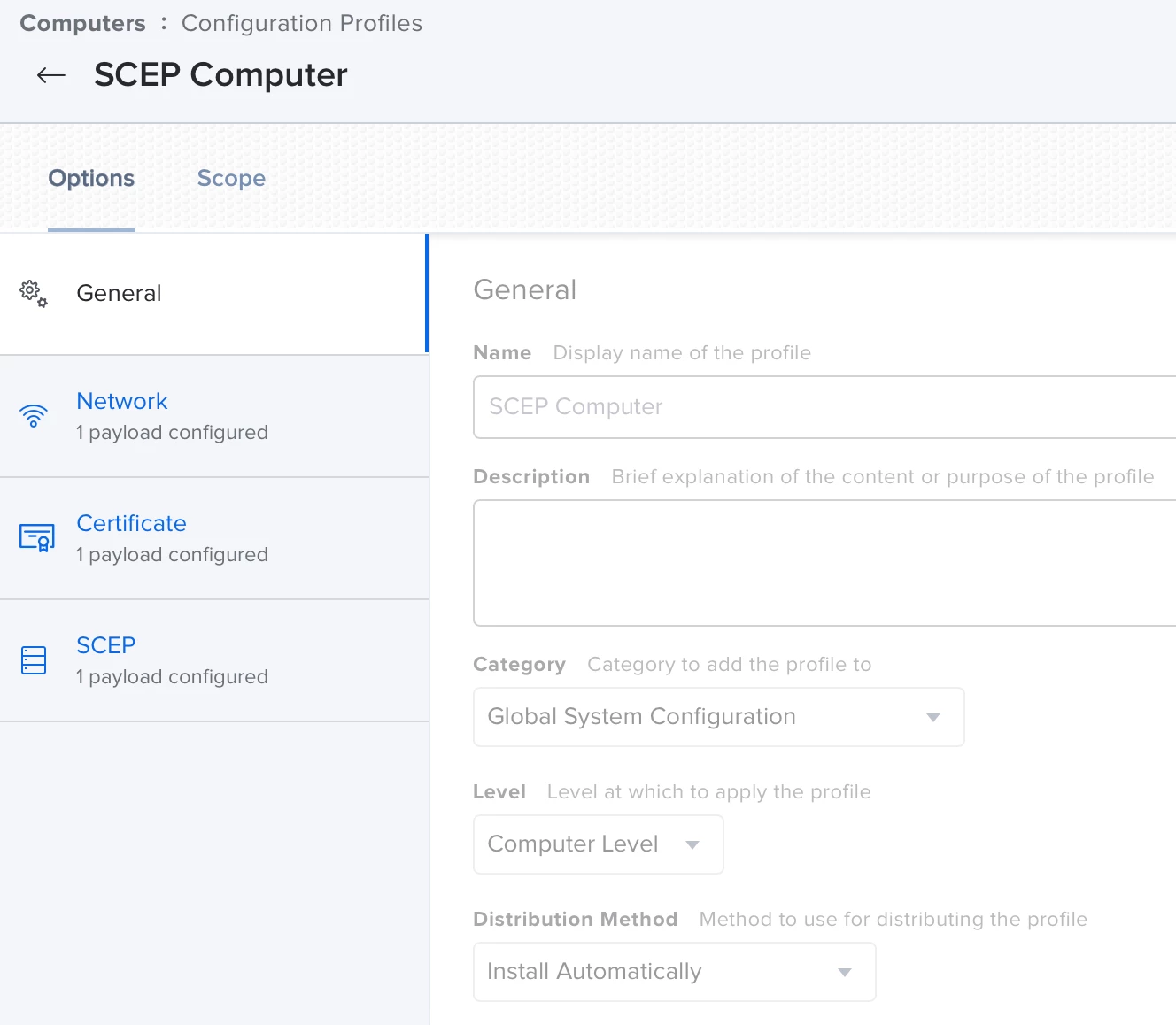

Thanks for that link. There's a section which says "If you are using an 802.1x RADIUS server for certificate-based authentication on your organization's network, you must make sure to distribute 802.1x settings at the computer-level" but gives no indication of how to set it up. Does anyone know what I need to do? Is there some kind of profile or policy that I need to implement to get the 802.1x settings in place?
You just need to send a computer level SCEP profile which provide a device based certificate and also has your network wifi configuration to auto join along with your root CA and EAP TLS trust to root CA.

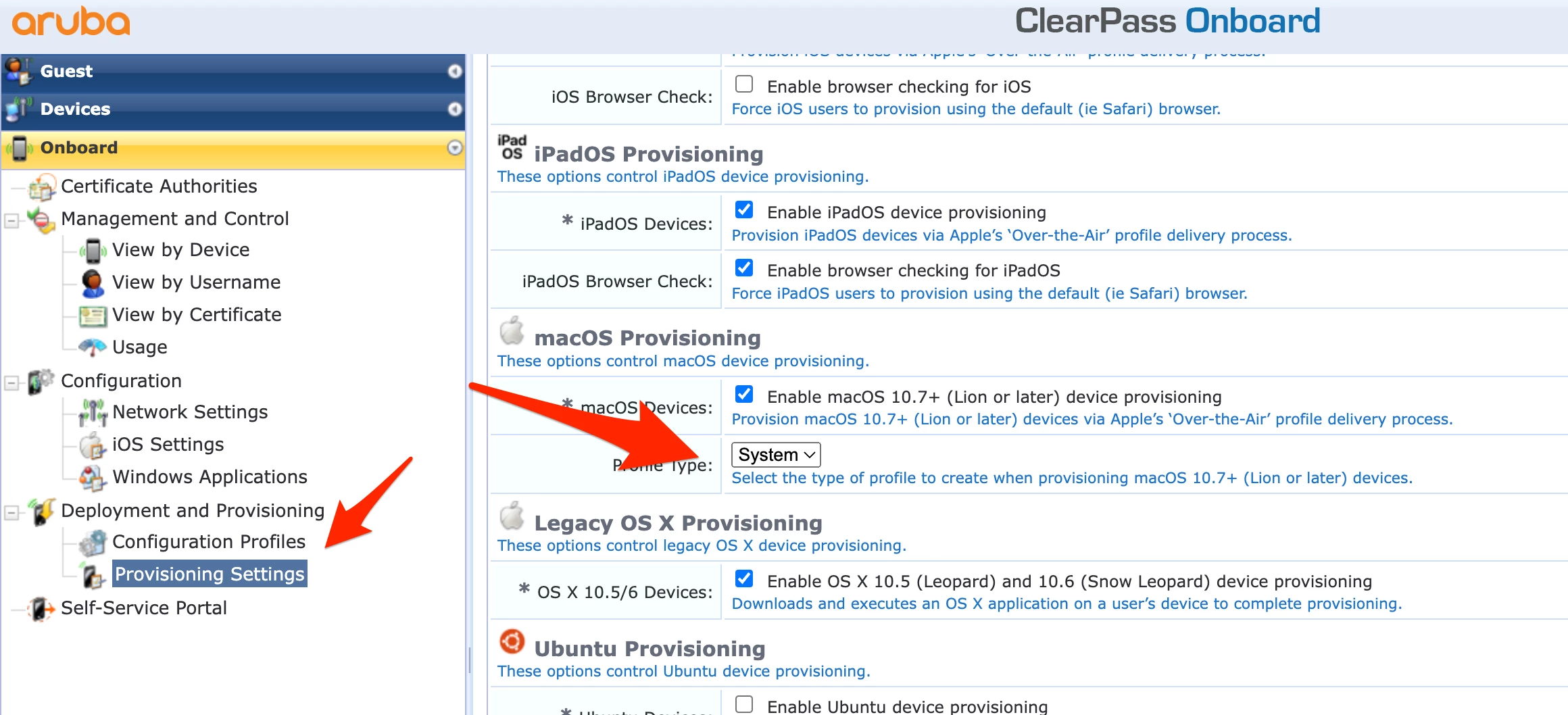

Hi,
We use Aruba brand Access Points in our WIFI network. 802.1x is used to connect to the network through these products and we include users in the network by verifying with a certificate. At this stage, identity and certificate verification is done with an application called ClearPass. The ClearPass application also serves as an MDM server and SCEP server. When we connect to Access Points, the ClearPass application sends a profile file to users via a web interface. Actually the whole solution is contained in this profile file settings. We changed the part specified as "user" in the settings of this configuration profile file, sent to MacOS devices by the ClearPass application, to "system". Thus, as soon as our MacOS device was turned on, the user was able to connect to the network automatically without logging in. If the application you use is ClearPass, I can support this article with screenshots.

Hi rolfk,
We use Aruba brand Access Points in our WIFI network. 802.1x is used to connect to the network through these products and we include users in the network by verifying with a certificate. At this stage, identity and certificate verification is done with an application called ClearPass. The ClearPass application also serves as an MDM server and SCEP server. When we connect to Access Points, the ClearPass application sends a profile file to users via a web interface. Actually the whole solution is contained in this profile file settings. We changed the part specified as "user" in the settings of this configuration profile file, sent to MacOS devices by the ClearPass application, to "system". Thus, as soon as our MacOS device was turned on, the user was able to connect to the network automatically without logging in. If the application you use is ClearPass, I support this article with screenshots. You can use the screenshot below. After making this change, you need to delete and reinstall the WIFI profile on the macOS device. After this step, the problem disappears.
husnudagidir
u have to enroll machine base certificate to get authenticate wifi and it supports only EAP-TLS authentication but PEAP(user authentication ) so it works only with machine base authentication
and map root CA in your wifi radius server for validation
Yes. Already the full solution to this problem is to do machine-based authentication. Because when devices enter the environment, they must be connected to the internet without being dependent on user authentication. Otherwise Jamf Connect will not work.

Your problem is that the certificate is in the user, not the system. Therefore, you cannot connect without logging in as a user. The certificate field should also appear as system in the WIFI profile you sent with Jamf.
