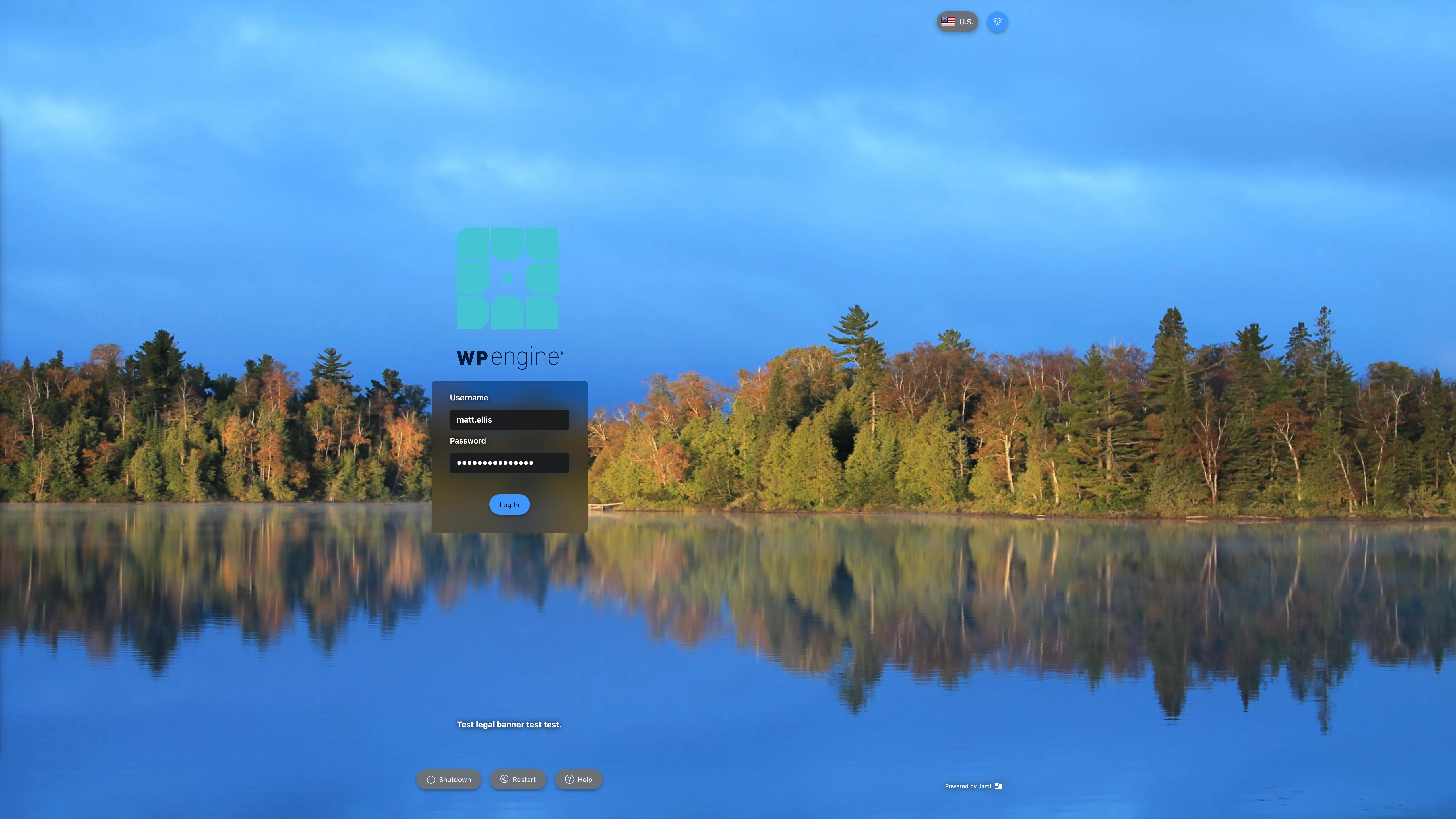

I had a ticket with JAMF about the JAMF Connect login window being off-center anytime I use a dual monitor. They attached it to a PI. But I wanted to create this discussion to see if more people have the issue and see if we can push this to a higher priority. Also, JAMF was able to reproduce.

I'm seeing this in my environment as well.

After deploying 2.3.2 and some more testing this appears to be fixed for all my test users so far.

I guess I’ll be waiting for a future update, given there’s apparently an authchanger bug in 2.3.2 causing config profiles to be ignored…

I'm running 2.4.0 and seeing the off center on dual monitor setups, so it is not resolved.
 I have this issue too. Just started a few weeks ago.
  • September 1, 2021
We are having similar issues, out SSO window is being cut in half when an external monitor is plugged in, If we disconnect the external monitor, everything is normal
