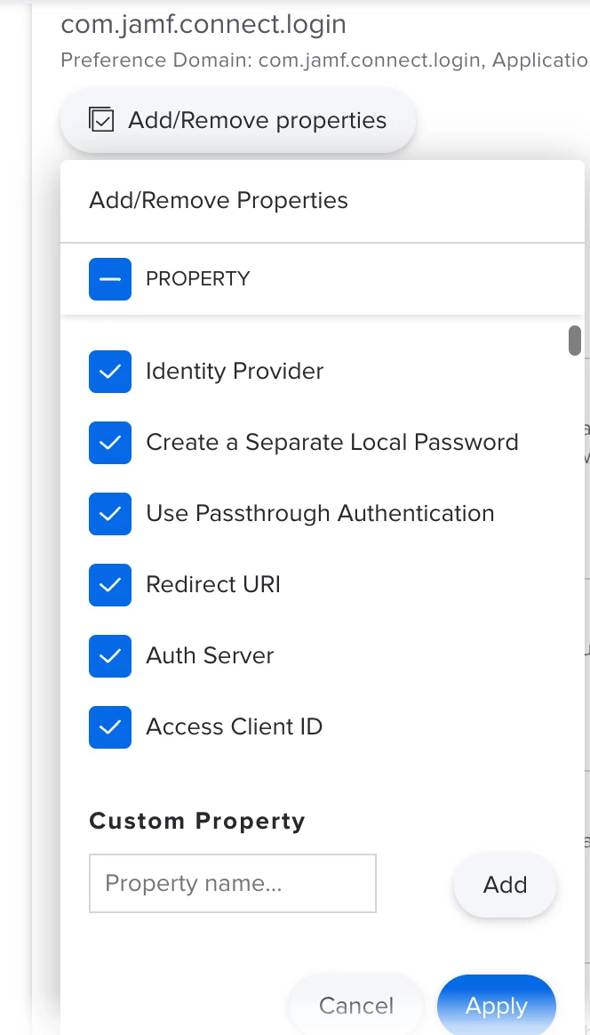

I do not have the DenyLocal property.
It is not available to add from the Jamf Pro configuration profile and it refuses to add it as a custom property. I suppose this is not used anymore. I do have this one though to allow local login if there are no internet connexion.
    <key>LocalFallback</key>
    <true/>
I'll keep trying to add DenyLocal true to see what happens. Maybe if I edit the plist manually on the computer.

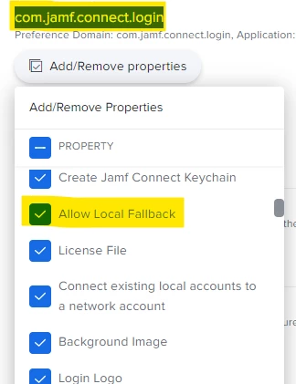

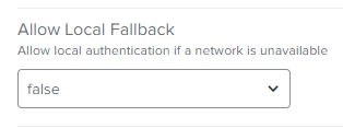

I had the same issue and I fixed it by disabling Allow Local Fallback under com.jamf.connect.login, this option is available in the built-in Jamf Connect config profile in Jamf Pro
<key>LocalFallback</key> <false/>
