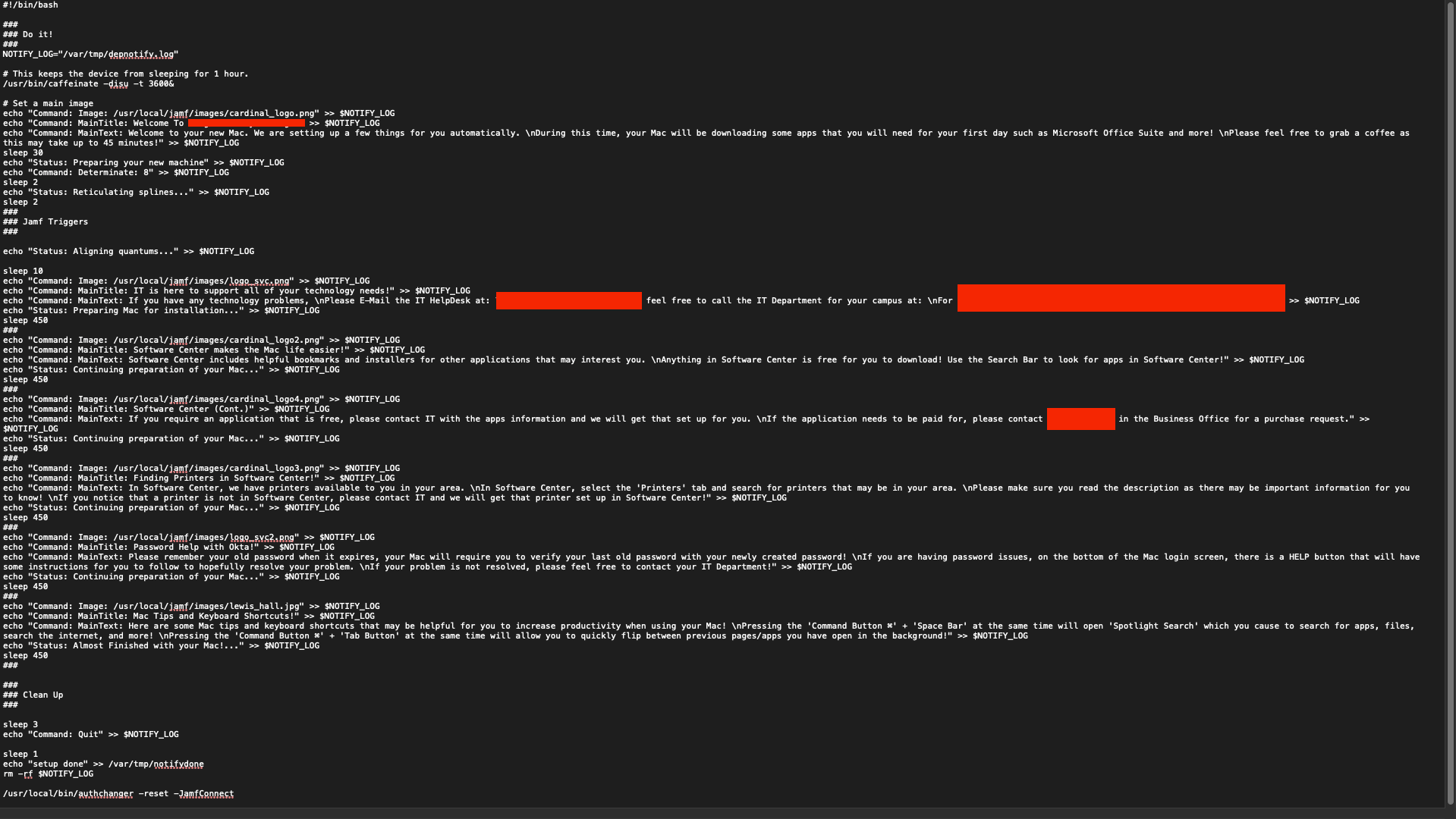

Hi, I have been having some issues with using the Jamf Connect Notify Screen feature. I have been using the Notify feature for a few months now and it had been working fine. Recently however, about a month ago, half way through the Notify slides/script, the screen will go black for about 10 seconds and then it will go back to the login screen. After you log back in, the notify slides become out of order and sometimes repeat slides. I have Notify set to run for about 45 minutes to make sure that all applications download before the user reaches the desktop and even with this issue, everything still gets downloaded.
Things I have tried doing;
  1. New prestage - thought maybe server issue
  2. Old prestage
  3. New package
  4. Old package - a package that worked before and doesn’t now
  5. Making sure no conflicting policies or config profiles
My question is has anyone ran into this issue before and how was it resolved?
Jamf is still new to me, so if I forgot any information, please ask and I will provide.
I will provide my script below.

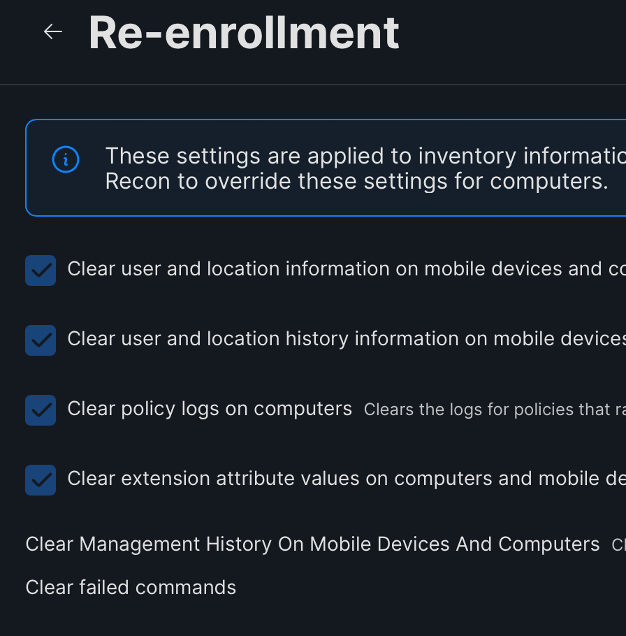

Hi did you find a resolution to this issue. I am having the same issue.
  • Feb 21, 2024 8:06 AM UTC
I found that having these settings checked under settings -> Re-enrollment helped in my case. Or just deleting the Mac before re-enrolling.
  • Mar 27, 2024 3:52 PM UTC
Clearing policy logs on computers should help for macs that are being re-enrolled.
Also, do you have a recon policy (/usr/local/bin/jamf recon) somewhere among your policies that runs right after enrollment? I was playing around with this for some specific setting I wanted to implement and noticed the same happened with my notify screen setup when the recon command ran during notify process.
