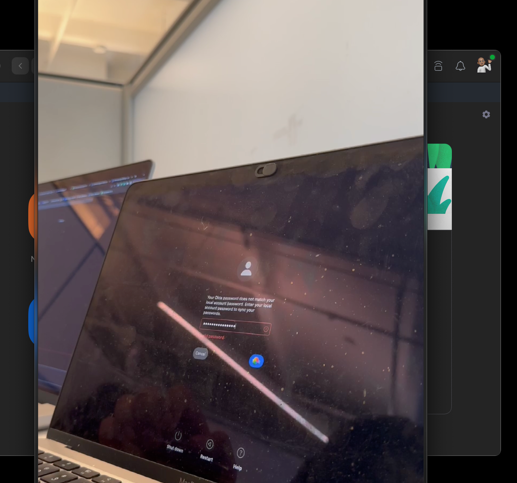

Hello I am dealing with a strange issue.
We are testing Jamf Connect and on my test machine when I get up to the step that says "your okta password does not match your local account" It does not take my new Okta password I just had created for some reason it is taking my old Okta password.

That screen is letting you know that the local password is not the same as your current Okta password. It should take the local password and sync it with the new Okta one. It's wanting your old password in order to update it.

Hmm alright appreciate the clarification. I am just a little confused.
So the only time I get to that screen is when I am on the okta login window on jamf connect and I put in my orgs email and a temp password I then create a new okta password.
Once i have created a new Okta password i get a screen change to verify my password. once i verify my new okta password the last screen brings me to that screen the image i posted above so when i put in my new okta password it doesn’t take it. it takes my old okta password only.
Not sure why that is the case. in our pre stage we have Skip account creation on not sure if that needs to be on.
