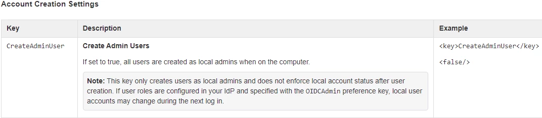

Check the configuration on the IDP side. We use Okta ourselves. However, depending on the Selected groups within the okta admin console okta will tell JAMF Connect to promote the account to admin or demote to standard account at login.
Offline authentications do not call okta (or google). So JAMF Connect does not know to change anything.

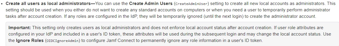

Oh yes I can see that in the Jamf documentation.  Thanks.  Now I need to figure out how to use it

Found it.  It was in the Jamf documentation again.  There is an option in the Jamf connect configuration tool to "Ignore role."
