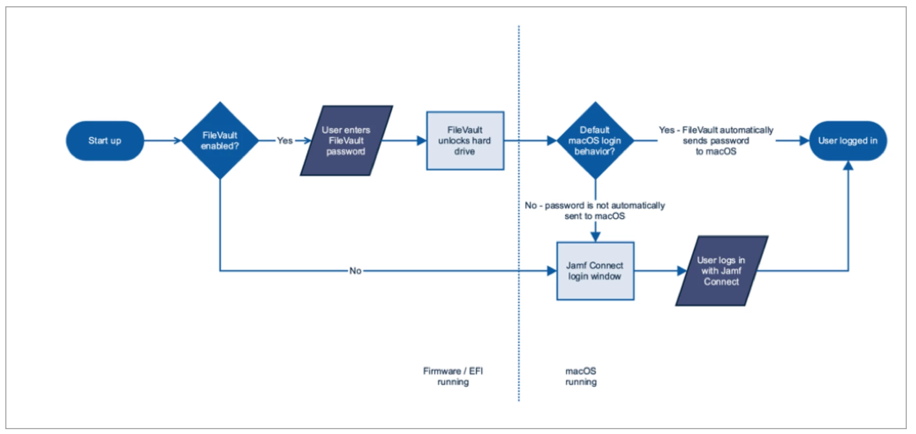

@timlarson Here is an diagram that's shows how filevault comes into picture before the Jamf Connect login window.
