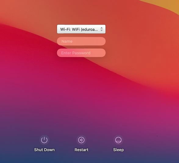

Has anyone further luck with this? I just tried a test profile using the steps above but had to tweak a little and it appears to have worked on a test MBP 2017 running Big Sur. I'll have to try it out on a few more machines just to make sure but if anyone is interested:
* The test machine is a MacBook Pro 13" 2017.
* macOS Big Sur 11.6
* We're using Jamf Pro 10.32.2
I started with a fresh configuration profile, filled in the General section and set it to apply at the computer level. I then set up the Network payload using some of the steps above that aassefa2 mentions support provided to him. I disabled Auto-Join because the first time I tried it it didn't work, so I disabled it this time. I went through the usual, set it to use the Wi-Fi interface, filled in the SSID and set up the security type. I checked the box for 'Use as a Login Window configuration'. I enabled PEAP protocols and 'Use Directory Authentication'
I also set up two payloads under the Certificate section. One for the Root CA that the school and uploaded a copy of the cert. And another upload for the cert that the wireless uses, they were in .cer format.
Back under the Network payload, under the Trust tab, I checked both uploaded certificates to be trusted and checked the box for 'Allow Trust Exceptions'.
After that I set the scope to the test machine, rebooted the MBP just to be sure, when it came back up there was a drop-down box with the SSID listed. I tried our test account and after a few seconds the login process started. It definitely took a few times and Jamf's documentation on setting up 802.1X authentication at login can be a little vague, but it was nice to see it actually work.

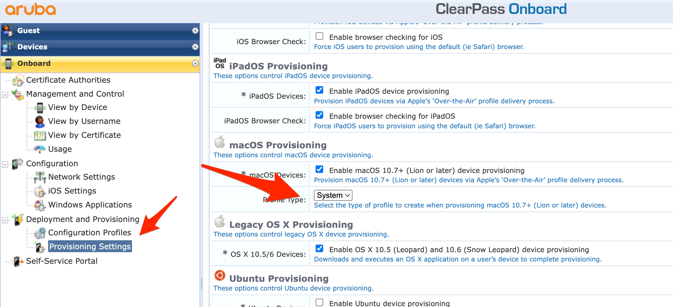

Hi,
We use Aruba brand Access Points in our WIFI network. 802.1x is used to connect to the network through these products and we include users in the network by verifying with a certificate. At this stage, identity and certificate verification is done with an application called ClearPass. The ClearPass application also serves as an MDM server and SCEP server. When we connect to Access Points, the ClearPass application sends a profile file to users via a web interface. Actually the whole solution is contained in this profile file settings. We changed the part specified as "user" in the settings of this configuration profile file, sent to MacOS devices by the ClearPass application, to "system". Thus, as soon as our MacOS device was turned on, the user was able to connect to the network automatically without logging in. If the application you use is ClearPass, I can support this article with screenshots.
husnudagidir
What resolved for you? I have seen it work once, but cannot replicate and Jamf Support has been no help sadly.
Hi,
We use Aruba brand Access Points in our WIFI network. 802.1x is used to connect to the network through these products and we include users in the network by verifying with a certificate. At this stage, identity and certificate verification is done with an application called ClearPass. The ClearPass application also serves as an MDM server and SCEP server. When we connect to Access Points, the ClearPass application sends a profile file to users via a web interface. Actually the whole solution is contained in this profile file settings. We changed the part specified as "user" in the settings of this configuration profile file, sent to MacOS devices by the ClearPass application, to "system". Thus, as soon as our MacOS device was turned on, the user was able to connect to the network automatically without logging in. If the application you use is ClearPass, I support this article with screenshots. You can use the screenshot below. After making this change, you need to delete and reinstall the WIFI profile on the macOS device. After this step, the problem disappears.
