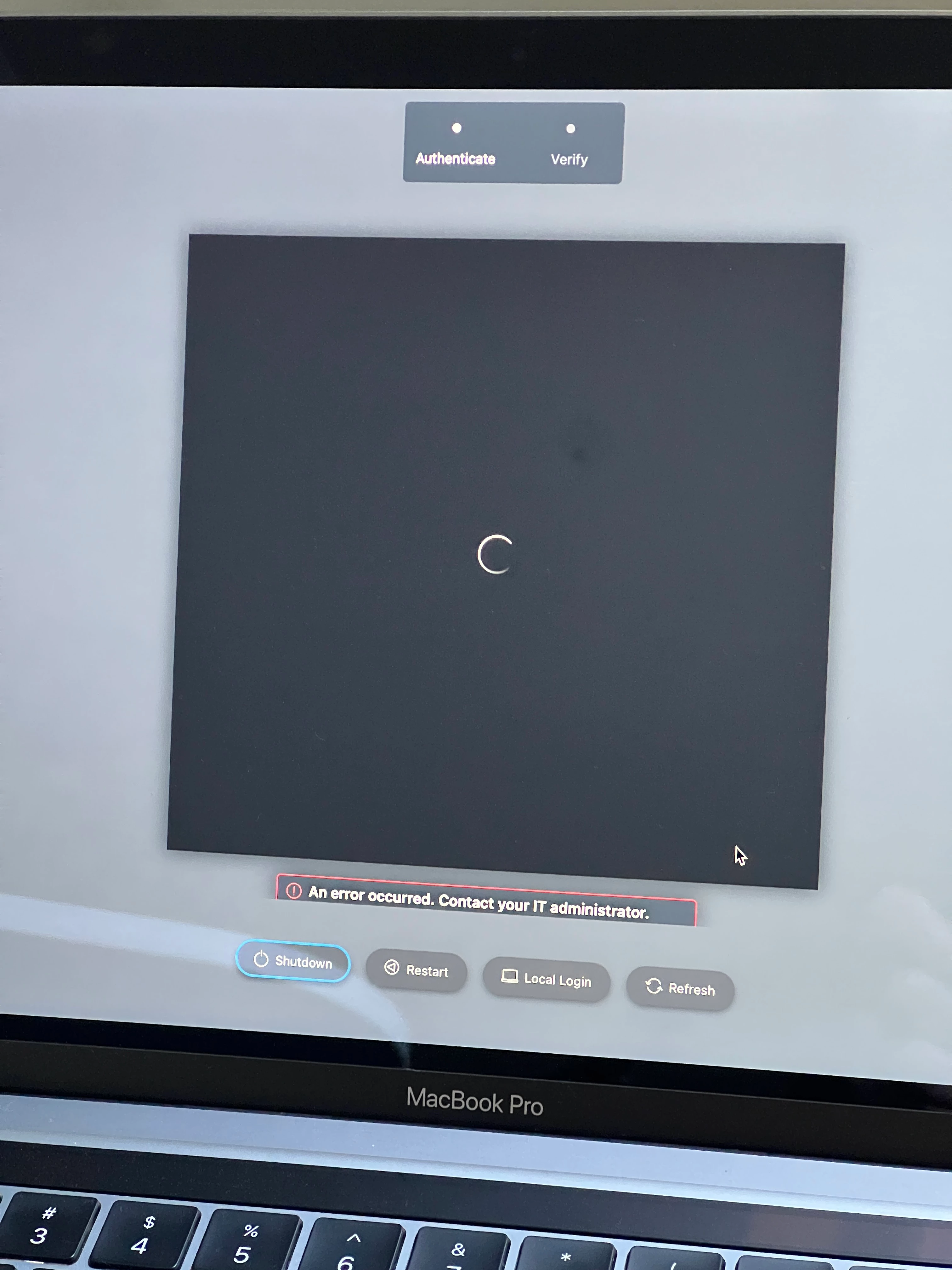

I have a test macbook that was enrolled into JAMF. I reimaged it via macOS Recovery, which installed a fresh new OS for Ventura. I thought maybe this was a Ventura issue, so I rolled back the OS to an earlier version (Big Sur) and the same issue occurs. I get this error: " An error occurred. Contact your IT Administrator "
Note: For clarity, the MacBook installs any macOS just fine, and seems to gather the enrollment profiles/policies from JAMF, but upon first boot (when the user should enter their SSO credentials), it gives this screen.

Basic questions but does your device have internet access at his stage i.e. it hasnt switched networks to somthing whcih requires authentication. Also is your jamf login profile signed, and is the cert on the profile still valid?  thats just looking like it cant get to your IDP

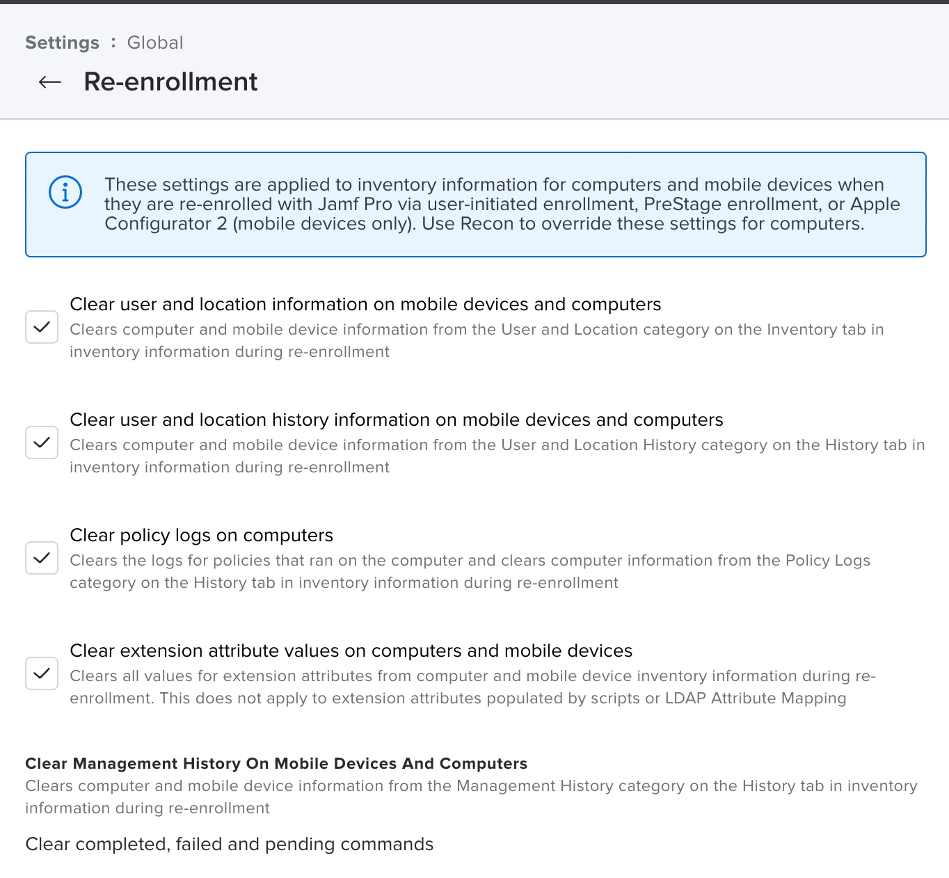

AtillaTheC
  • December 20, 2022
Did you delete the record in Jamf prior to re-enrollment? If not do you have re-enrollment settings set properly?
janzaldua
  • December 20, 2022
I did not delete the record, but we do have re-enrollment settings set properly I believe.
Keep in mind, this is the only system having the problem. I've wiped and re-enrolled systems many times over the past year without an issue. I could try deleting the record in Jamf, but I was more curious why this was happening.
AtillaTheC
  • December 20, 2022
OK if those settings are set that way then i'm unsure. Could be a firewall issue maybe? Have you tried on a different network? If its the same on a different network may be ideal time to open a support case with jamf to review your logs.
