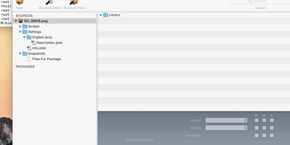

@mm2270 - sounds simple to do, i'm new to this, so I just want to make sure i am doing this correctly, (did this correctly)
I moved the file into /Library/Apli...../JAMF/bin , changed the owner to root:wheel, chmod 744
launched Composer, then from Finder i dragged the image file from /Library/Appl..../JAMF/bin into Composer.
not sure what to exactly look for in the files/folders that were created, (gave a description in Description.plist) clicked 'Build as PKG'
I attached a couple images pre 'build as pkg'

  • March 23, 2015
@tcandela So if you turn down all the directories in your Composer source above, like "Library" then "Application Support" and finally, "bin" is the icon file shown? If so, then it looks good from where I am. The "Files for Package" line shows its there, but always a good idea to double check if you haven't already.
If all looks good, build it out as PKG or DMG and upload to your Casper Admin share. Start deploying to your Macs in a policy.
You may want to create a Smart Group for the Macs in your Site that do not have the specific package receipt on them as the scope for the policy so it will know which ones to deploy it to.

@mm2270 - I am running the package just as is, nothing has been removed.
I checked my test computers and the *.png is in the /Library/Application Support/JAMF/bin directory.
I changed the script to icon="/Library/Application Support/JAMF/bin/*.png" and it displays alongside the jamfhelper message.
regarding you 'Smart Group' input, which criteria would equal the specific package receipt? would it be the criteria of 'Packages Installed by Casper' 'Has' 'Install GUpng Image'
