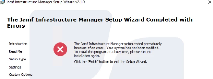

Does anyone have recommendations for installing Jamf Infrastructure Manager? I am receiving the attached rollback error after initiating the installation and entering the verified parameters. I used the following as resources:

I currently have a ticket open with Jamf but so far the troubleshooting suggestions have been fairly basic steps that I had already taken like ensuring the FQDN is used for hostname and installing from an elevated command prompt session. The login credentials for the API user are also valid.
The installation log is extremely verbose but I parsed every single line. There is a single 1603 error reference indicating SYSTEM doesn't have file permission access but it does. The only other relevant information the log provides is to validate that the installation parameters were entered correctly.
Best answer by macinblack
@xian Thanks for your response. I forgot to mark this resolved. I submitted a ticket to Jamf and it made its way to a couple of engineers who were able to help us diagnose the issue. It turns out that Amazon Corretto 11 is not just the recommended flavor of Java for JIM 2.1 (we were using OpenJDK 11.0.7) but is, in fact, a requirement to get it working with Windows Server 2016. I can't speak for previous or newer versions of Windows Server, but that is the case with the current build of WS16.

I also noticed this in the logs and realized I misinterpreted the 1603 error at first glance. It seems to be an issue with the API user account but I tested the account and verified it works and that the information is correct. I temporarily gave the account full permissions for testing too.
JIM (c) (12:01) [18:06:56:633]: Getting an enrollment invitation for the Infrastructure Manager from the JSS...
Exception thrown by custom action:
System.Reflection.TargetInvocationException: Exception has been thrown by the target of an invocation. ---> System.ComponentModel.Win32Exception: The system cannot find the file specified at System.Diagnostics.Process.StartWithCreateProcess(ProcessStartInfo startInfo) at System.Diagnostics.Process.Start(ProcessStartInfo startInfo) at Jamf.InfrastructureManager.InstallUtilities.Utilities.LaunchExe.Start() at Jamf.InfrastructureManager.InstallUtilities.JssInvite.GetInvite() at Jamf.InfrastructureManager.InstallUtilities.CustomActions.GetJssInvitation(Session session) --- End of inner exception stack trace --- at System.RuntimeMethodHandle.InvokeMethod(Object target, Object arguments, Signature sig, Boolean constructor) at System.Reflection.RuntimeMethodInfo.UnsafeInvokeInternal(Object obj, Object parameters, Object arguments) at System.Reflection.RuntimeMethodInfo.Invoke(Object obj, BindingFlags invokeAttr, Binder binder, Object parameters, CultureInfo culture) at Microsoft.Deployment.WindowsInstaller.CustomActionProxy.InvokeCustomAction(Int32 sessionHandle, String entryPoint, IntPtr remotingDelegatePtr)
CustomAction JIM_InstallUtilities_CA_GetJssInvitation returned actual error code 1603 (note this may not be 100% accurate if translation happened inside sandbox)
Action ended 18:06:56: InstallExecute. Return value 3.
