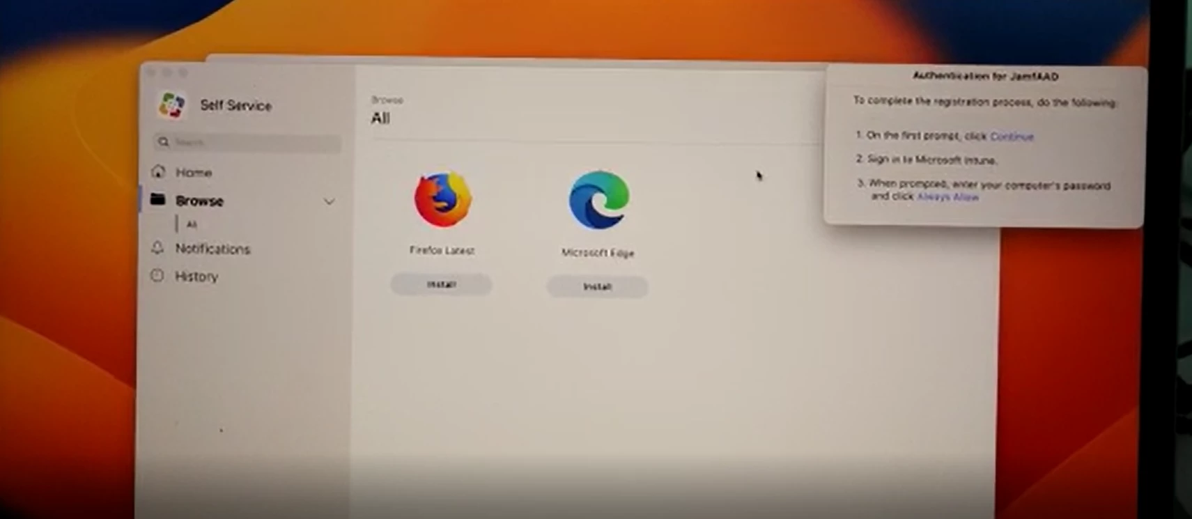

Hello,
Has anyone been able to run Microsoft Intune Integration on Macbooks with Intel chips and Ventura OS?
We tried to run the policy on Macbooks with Intel chips and Ventura OS but the integration doesn't work and the device will never get registered in AAD.
We also tried with M1 chips, but there is no issue, on macbook with Monterey OS and Intel chip, the integration will work.
The integration will stop at this step on intel devices with Ventura:
We already tried with different browsers, deleting the profiles, using webview and reenrolling the device and everything else that could be found on the internet.
Has anyone been able to make this integration between Jamf and Intune with this scenario?

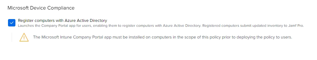

How is your connector setup? Did you use the cloud connector to connect macOS and Intune Integration under Conditional Access? And did you set up the partner connector in End Point Manager or was it done for you? Just asking as we are not seeing issues registering Ventura laptops.
  • Dec 13, 2022 10:00 PM UTC
Yes, we are using cloud connector, after completing the user enrollment, we are running the integration script from Self Service and the device should receive an Azure AD and check for compliance status.

Can you verify the app in Intune for the connector has the correct permissions:
The Jamf Pro enterprise application in Azure has the wrong permission or more than one permission. When you create the app in Azure, you must remove all default API permissions and then assign Intune a single permission of update_device_attributes.
This would cause the registration to fail.
I am guessing your MS licensing is at least a P1 and your Jamf clients have valid licenses?

To weigh in, I’m seeing the issue as well and it works as expected for Intel devices with Monterey, and for Apple Silicon Devices with Ventura but NOT for Intel devices on Ventura.

For us, for ages, we've always failed on the first attempt - worst case the JamfAAD app hangs on the first try and has to be forced-quit. On the second attempt it works. I reached out to Jamf Support who wanted full system logs, which I did not give them.
Since then, I've also implemented the web app support in JamfAAD, but looking at the suggestions above it's possible your problem is competely different.
It just seems like you're not getting the last login window from a browser or WebView, which is what I had.
