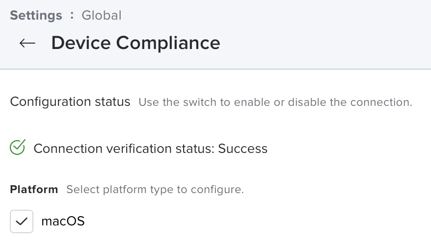

I'm trying out the new PCM Device Compliance feature for macOS and am running into a problem. When running the "Microsoft Device Compliance" policy, it launches Company Portal, I login and it seems to complete the registration without issues. When I lookup the device in InTune, it's not there at all. In Azure I see the following:
  • Join Type: Azure AD registered
  • MDM: None
  • Compliant: N/A
I configured the feature according to this technical paper: https://learn.jamf.com/bundle/technical-paper-microsoft-intune-mobile-devices-current/page/Integrating_with_Microsoft_Endpoint_Manager_Introduction.html
Any help would be appreciated.

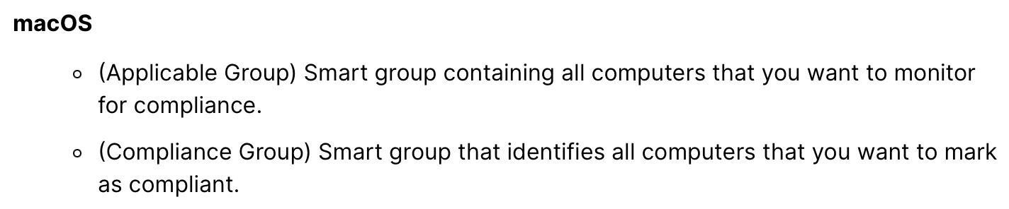

Best answer by sakul
I found the issue! It was a very dump mistake on my part.
I had the "Applicable Group" and "Compliance Group" fields mixed up 🤦‍
To my justification, all documentation I've seen, first describes the "Applicable Group" and then the "Compliance Group", while the Jamf settings page has them the other way around. So if you're not paying attention, you might mix them up. I think the order as documented makes more sense.

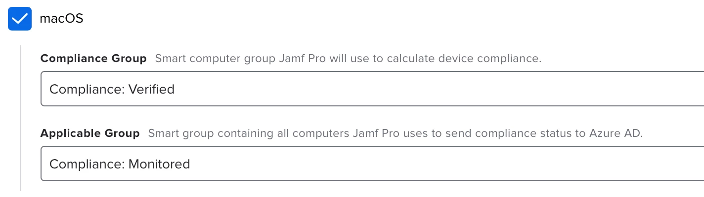

"Compliance Group Smart computer group Jamf Pro will use to calculate device compliance." - The smart group that is connected to this one is the one that tells Jamf that these devices are Compliant and members here will make it so in Azure compliant is "Yes". So if the device is not a member of this smart group the compliance status will show "No".
So this smart group is where you wanna set certain criteria, for example Firewall needs to be ON, just one example to meet criteria to be a member of this group and count as being compliant "Yes".
"Applicable Group Smart group containing all computers Jamf Pro uses to send a compliance status to Microsoft Intune. This also makes the Register button available in Self Service." - Computer members of this smart group is what tells Jamf to send status to Azure.

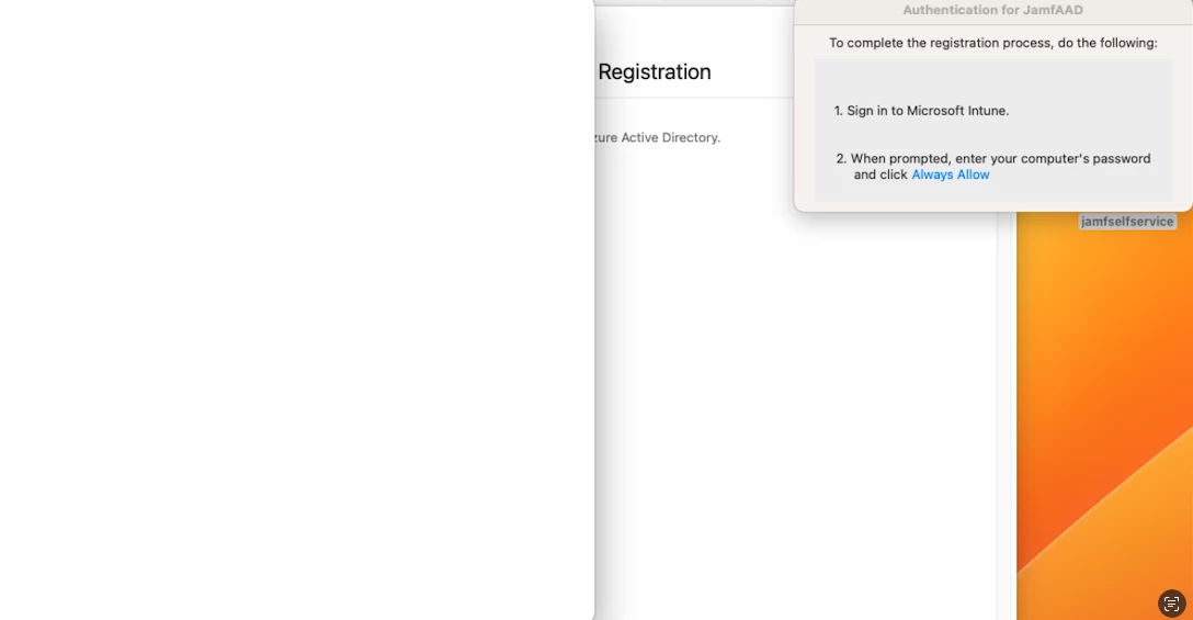

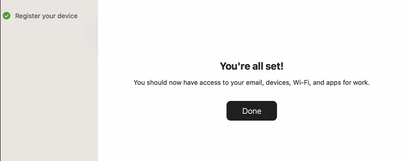

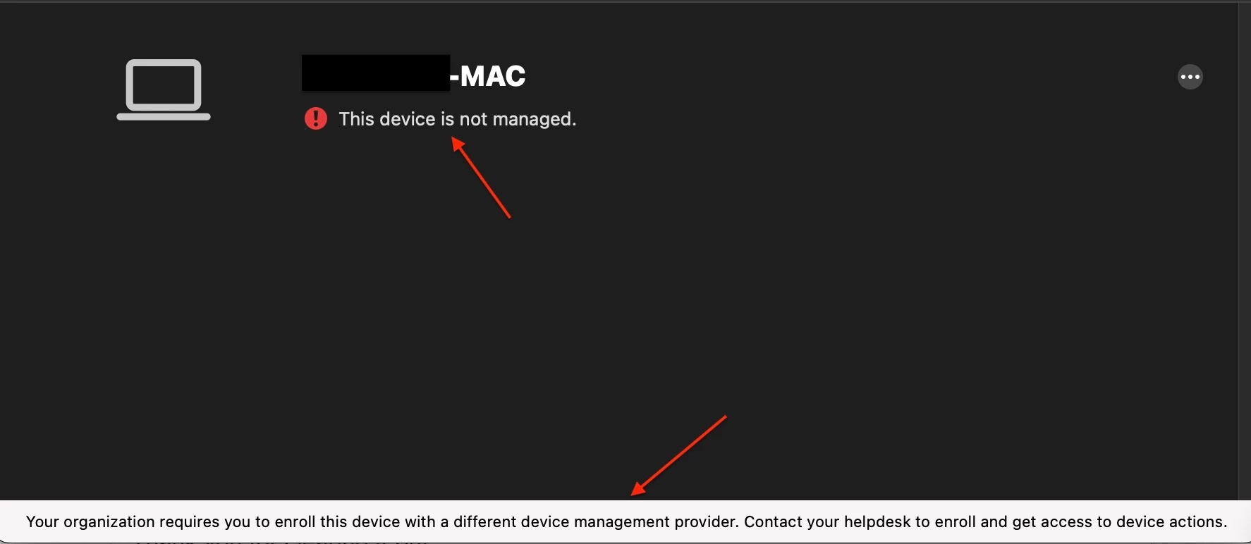

Now, remember you don't find the device object in Intune (meaning endpoint.microsoft.com) the devices that has registered with Company Portal are only showing up in Azure AD under devices and that's were you will see the compliance status as well (Yes or No).

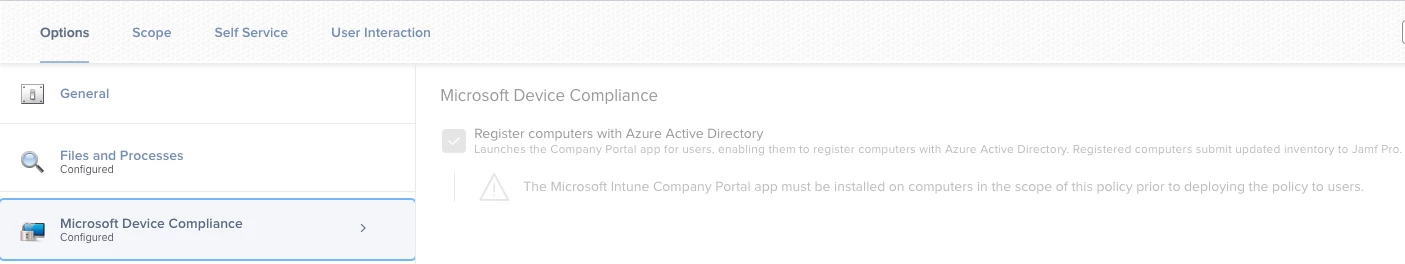

When we at first were registering devices with Company Portal we had issues. We were getting the message "You're all set!" and the device was showing up in Azure AD under devices BUT on MDM it was saying "None" and Compliant "N/A".

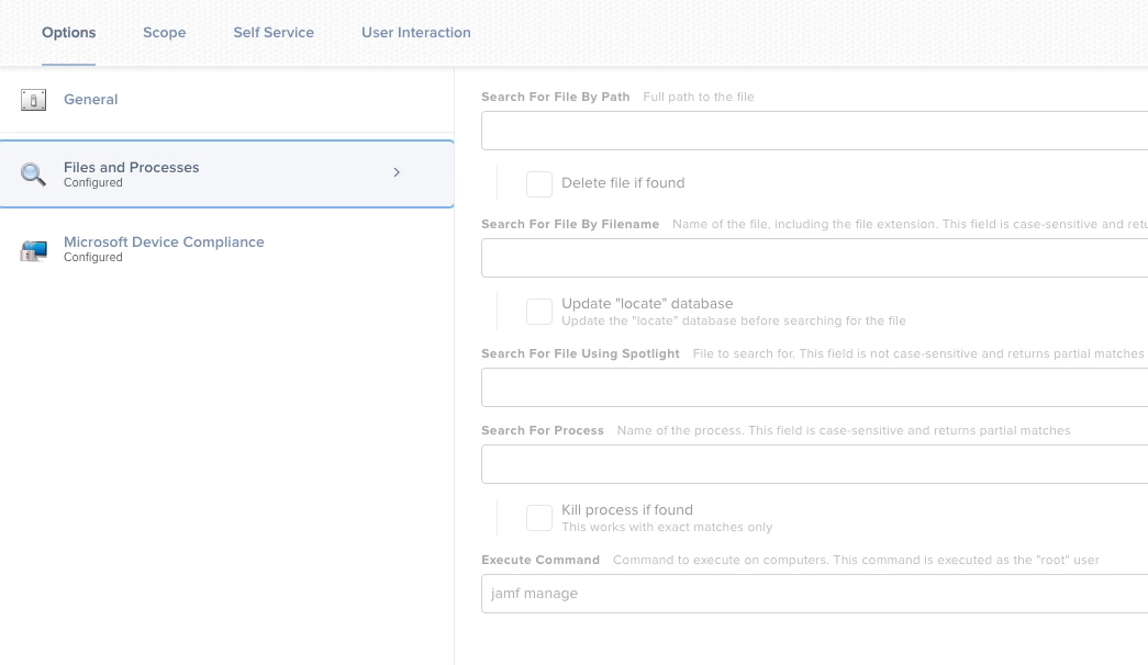

We later figured out, via other posts here in Jamf community, that if you add in the policy where you are running the payload "Microsoft Device Compliance - Register computers with Azure Active Directory"
A "File and Processes" payload and "Execute Command" you run "jamf manage", so that basically "jamf manage" runs before registration.
After doing this, device registration to Azure was working every time. Devices were showing up in Azure showing MDM "Microsoft Intune" and also the Compliance status Yes/No
The reason it wasn't working before running "jamf manage" was because the jamfAAD authentication never popped up, meaning this part:
That authentication needs to be done. When that is done it also creates a .plist file called jamfAAD.plist and it's location is under users folder: "/Users/$loggedInUser/Library/Preferences/com.jamf.management.jamfAAD.plist"
If that has been created then you know the jamfAAD authentication was done correctly.

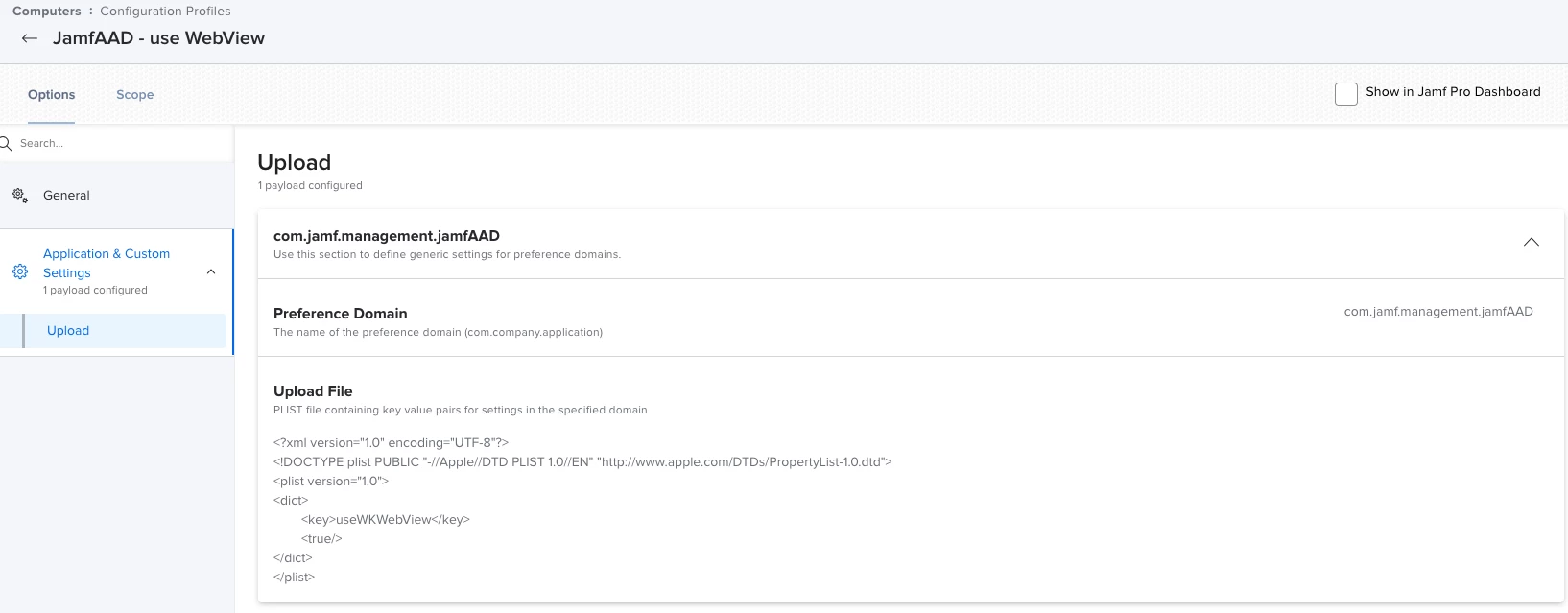

I can add that we automated the jamfAAD authentication as well by adding a configuration profile (CP) with this .plist settings:
<plist version="1.0">
<dict>
<key>useWKWebView</key>
<true/>
</dict>
</plist>

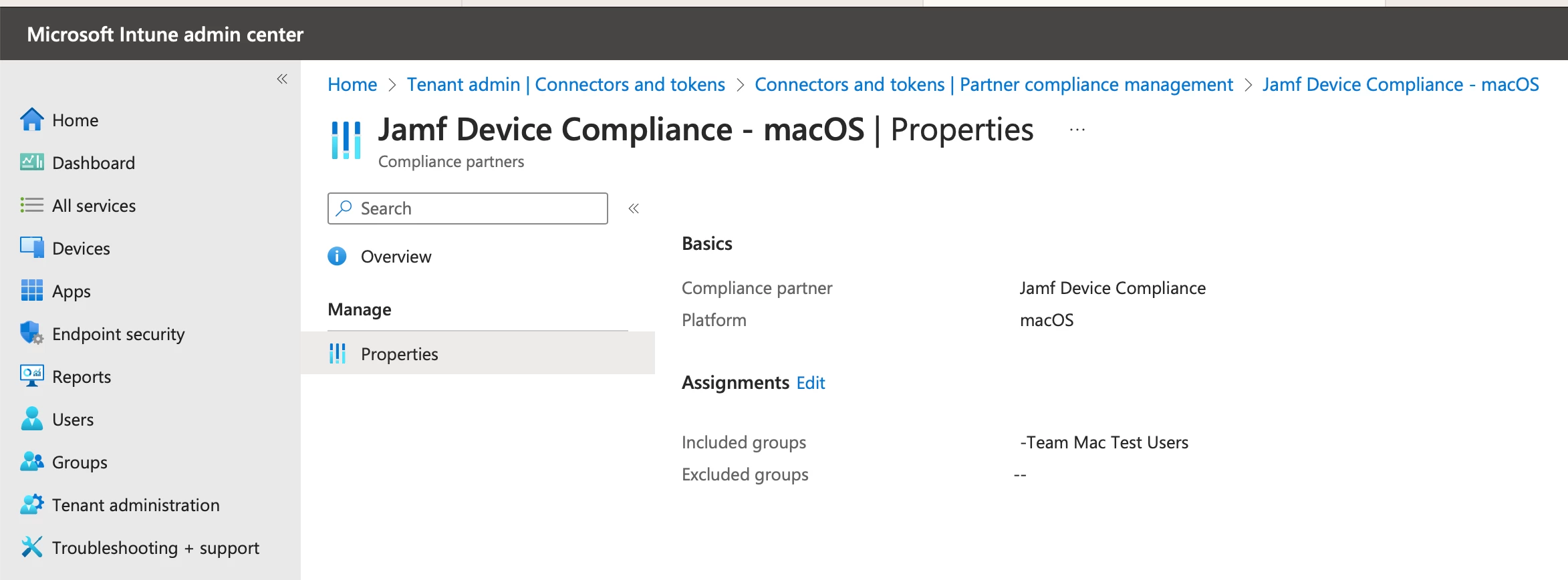

Hi @nadsad,
All of the above steps are correct. One thing if you have not checked yet.
Go to Microsoft Intune Admin Center —> Tenant Administration —> Partner Compliance Management —> Select Jamf Device Compliance —> Go to Properties —> Check if the user that you are trying to enrol with intune is present in the AD Group mentioned in Included Groups.
