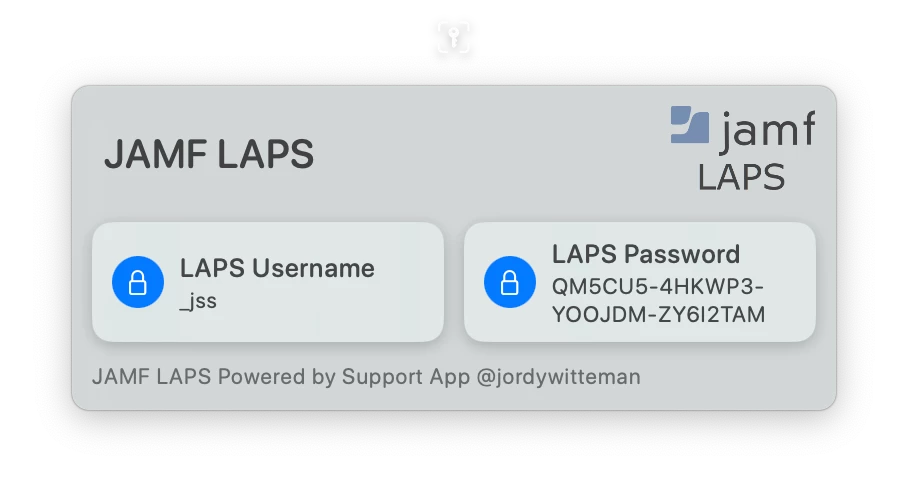

If anyone is interested I've got another JAMF LAPS tool. Its a menu bar app which displays the LAPS password for the current device. https://github.com/PezzaD84/JAMF-LAPS-Menubar-app
  • Sep 16, 2024 7:22 PM UTC
