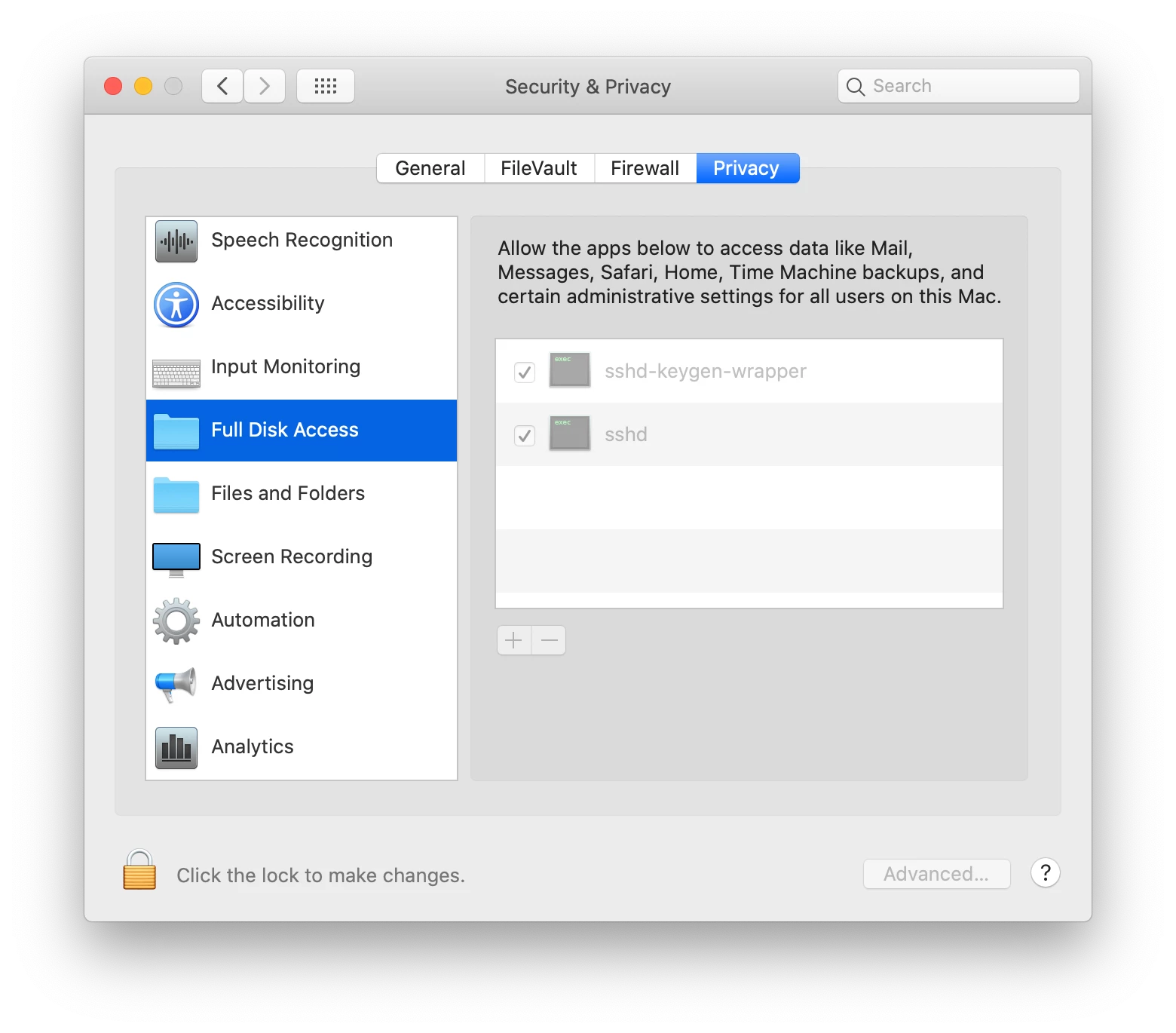

And as an FYI, when you use Jamf Remote or SSH into a computer the parent process is actually sshd-keygen-wrapper. That automatically gets added to Full Disk Access every time you SSH or Remote in.
If your end users are admins and go into Security & Privacy > Full Disk Access and just uncheck the box for sshd-keygen-wrapper, Jamf Remote would fail to mount SMB/AFP shares on macOS 10.16 computers and policies would fail. If they were to remove sshd-keygen-wrapper from the list using the minus symbol it would just be added back at next remote connection and Remote would function fine. If you are concerned about that you can ensure that doesn't happen by moving to an HTTPS distribution point. Or a more extreme method would be to push out a PPPC profile that whitelists sshd-keygen-wrapper for SystemPolicyAllFiles.

For more clarity on the sshd-keygen-wrapper, that would only need to be whitelisted for Full Disk Access if you use Jamf Remote or ssh into computers and you run a policy that needs to mount an AFP/SMB share and you were worried that someone would go into settings and disable it. By default when you connect via SSH that gets added to Full Disk Access automatically.

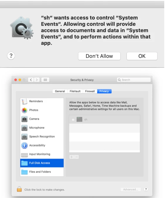

@mike.paul Is this also related to the following scenario we also discovered later in the beta:
Skype for Business 16.28.120 part of our DEP provisioning policy prompts 'sh' (binary) wants access to control "System Events".
It adds an additional 2 mins to our provisioning workflow due to the prompt waiting for the users input behind SplashBuddy...

@JarvisUno, as I mentioned above, I was successful in enabling ssh using jamf startSSH via a policy. Until Jamf Pro 10.16 comes out with a fix for enabling at Startup and Enrollment thats the ticket. I can't speak to your scripts results as I don't know what's in it and Im typically not one to troubleshoot peoples scripts.

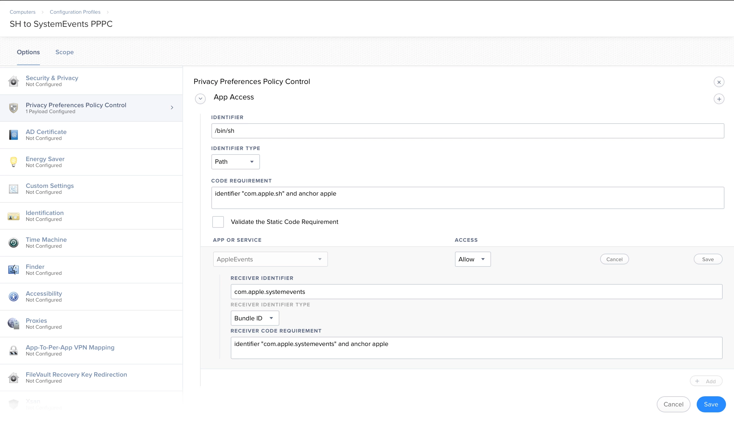

@myronjoffe, Id maybe reach out to Skype to try to see what they changed. But yea, the script is probably the parent process so sh needs access to systemEvents, which is typically used for prompts to end users which shouldn't be popping up during provisioning anyway. But you could try allowing sh to talk to systemEvents via the Apple Events connector in PPPC and push that profile out during the DEP enrollment.

Thanks @mike.paul I've tried reaching out to the Skype team on Slack but heard recently that one of their lead devs who has been with MS for ~30 years recently packed up and left...
Im not that comfortable with giving /bin/sh to System Events if it can be avoided. Will log this with MS :)
