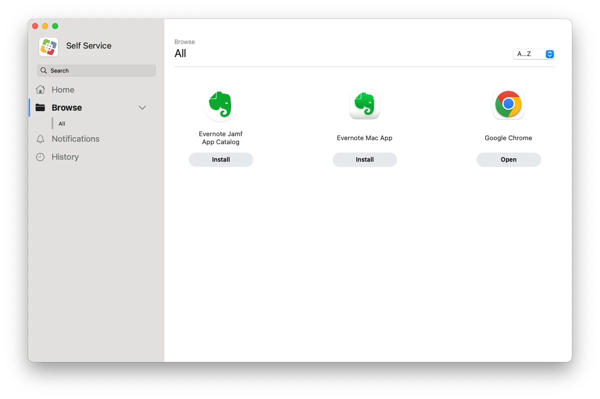

Experimenting with Self Service and noting that if an application is installed, albeit I'm just testing with Chrome, through the Self Service app and then deleted it is not possible to reinstall the app through Self Service a second time. For Chrome, it initially displays Install which changes to Open when successfully installed but doesn't revert to Install if the app is removed. How can the option in Self Service be reinitialized?

  • January 11, 2024
@MikeyK, @easyedc, thanks for the feedback, though will confess to having got myself a bit confused given that I've mixed up two issues in this exchange.
Issue 1
There is the issue of installing an app through Jamf Self Service (JSS) which when deleted is not available for reinstallation through JSS again, i.e. the example app Chrome goes from Install > Open and then remains as Open when deleted. This app is installed having been set-up under Jamf App Catalog as opposed to App Store.
The scenario I'm trying to address is where an end user installs an app, mistakenly uninstalls the app and needs to be able to reinstall the app.
Issue 2
The installation of off-the-shelf apps, i.e. the kind of apps available through App Store, without the user requiring to create/user an Apple ID. JSS seems to be a solution to this. Having first set-up a three apps under Jamf App Catalog, two for Install automatically and one for Self Service, all was working well. When testing Evernote having set it up under both Mac App and Jamf App Catalog, it appears that Mac App is no more than a shortcut to App Store - complete with being prompted for an Apple ID - while Jamf App Catalog will install the app prompt free.
In essence my own testing has confirmed that our in-house deployment will be through Jamf App Catalog, to save users having to set-up and manage an Apple ID. Using Jamf App Catalog seems to be an easier, and obvious choice as otherwise users might as well go direct to the App Store.
