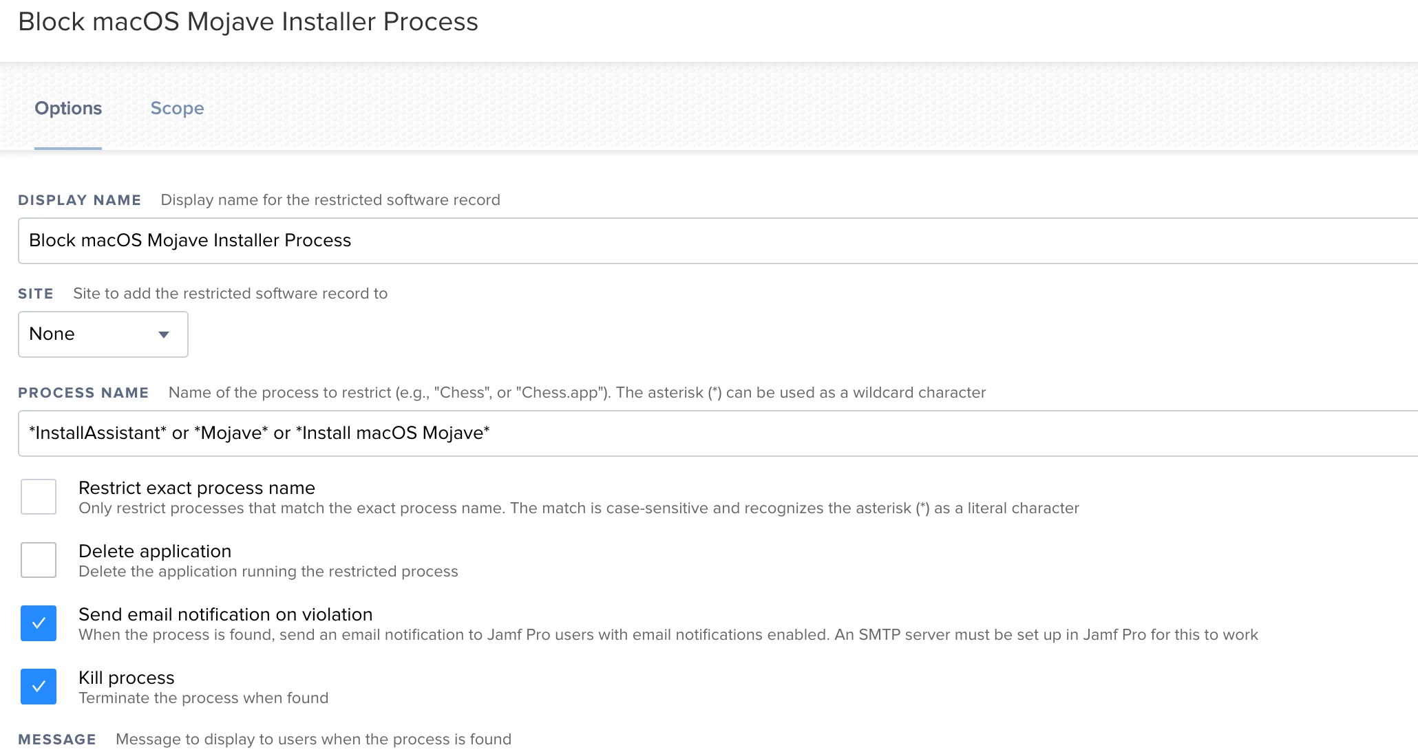

@danshaw InstallAssistant is the process name you'd want to block.
  • Nov 30, 2018 5:44 PM UTC
Thanks @bpavlov . Looks to be updating now properly. The last piece I am struggling with is how to push down some Kernel Extension Config Policies immediately after the upgrade. Without them, users get popup notifications.

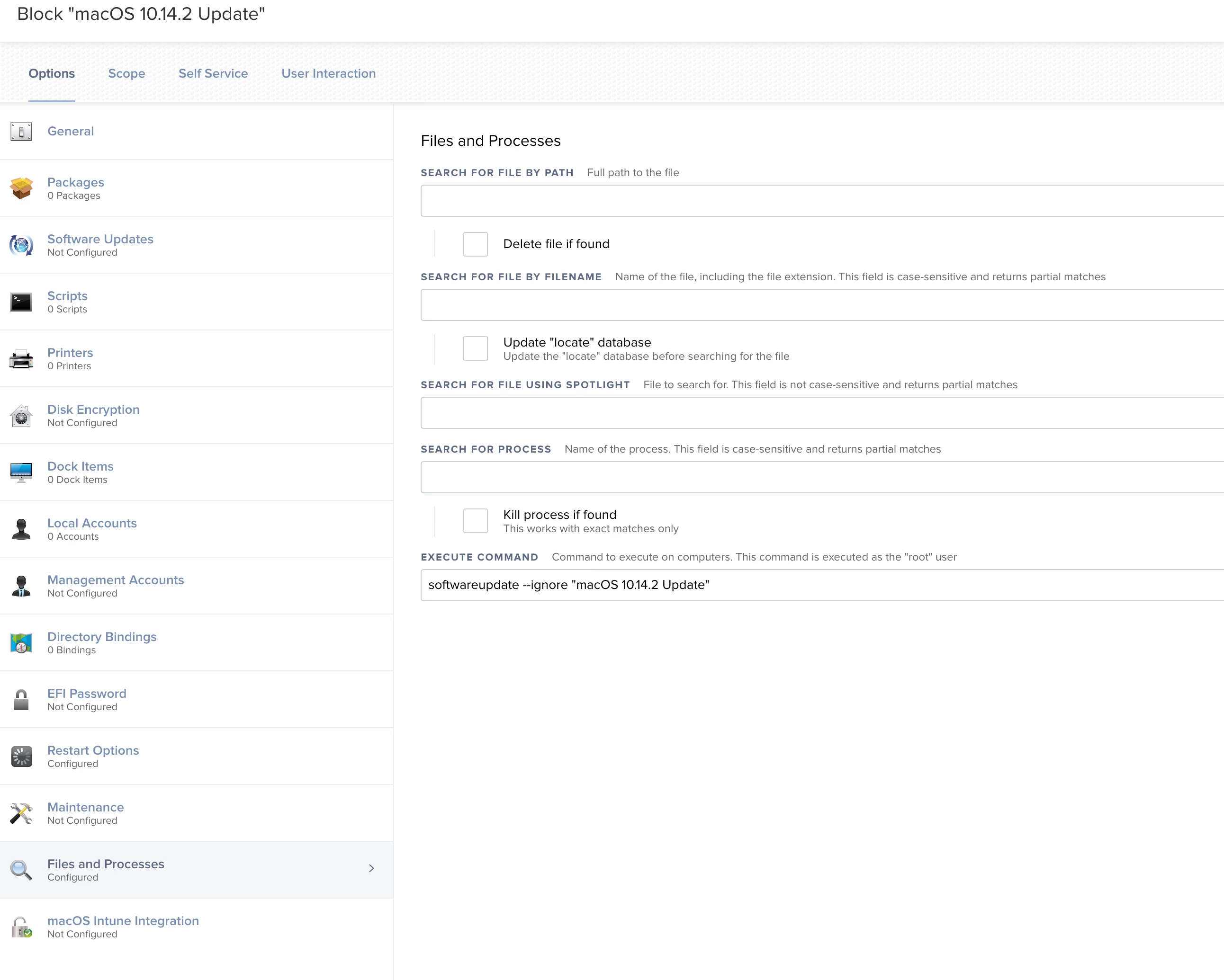

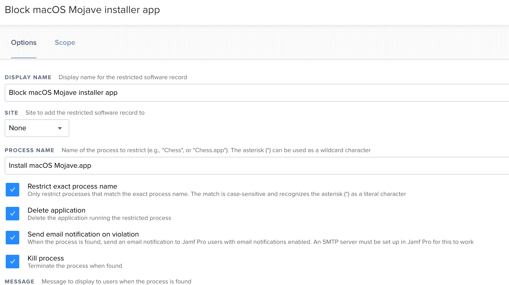

@danshaw We use the Restricted Software and it seem to work pretty good.
You need two from what I can gather.
I also use this to hide 10.14.x releases
So far it has been working for us, Starting with High Sierra last year.
-Peter

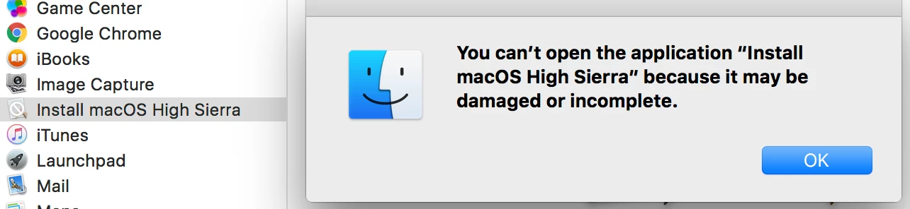

I'm having issues getting past the initial phase. When i wrap the 10.13.3 into a DMG it places the the app into applications folder but does not recognise the app as it is damaged or incomplete. When installing it manually from the DMG it works fine and the .app appears in the applications folder as it should.
I have re-packaged the macOS as an HFS+ as 90% of the environment are still on this file system and was packaged using Casper 9 but still getting the same result
Is there something else I can do?
