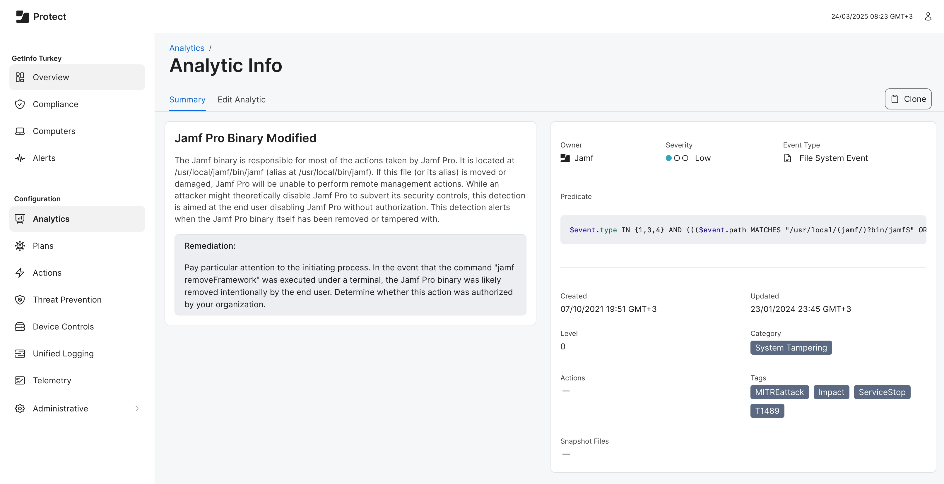

hüseyinusta12
Are you looking for a solution other than the built-in "Jamf Pro Binary Modified" analytic, or does it meet your needs?
