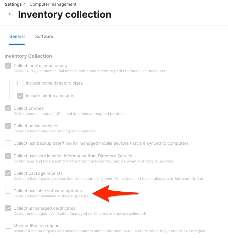

@Couriant - I've faced this issue while collecting available software updates information during inventory collection. Try disabling that and see if it speeds up the inventory update without any failures. It's worth noting that we're using a customized macOS Software Update Workflow that doesn't require this information, so we've disabled it. If you need this information, please bear with the delay.
Sweet... that worked for me (fwiw). I thought I had a bad EA somewhere and had been putting off troubleshooting.

As @AJPinto mentions, you should run your recon in verbose mode, because the jamf binary is multi-threaded for some years now, so just because it looks like it's hanging on the hardware inventory doesn't actually mean that's where it's getting stuck. The verbose switch will reveal what its stopping on. Generally speaking, with the exception of the built in software update collection, which relies on the Mac being able to connect to an external service (Apple), most of the native jamf binary inventory collection options are fine. It's usually something we have added to the inventory that's the culprit, like an Extension Attribute.
