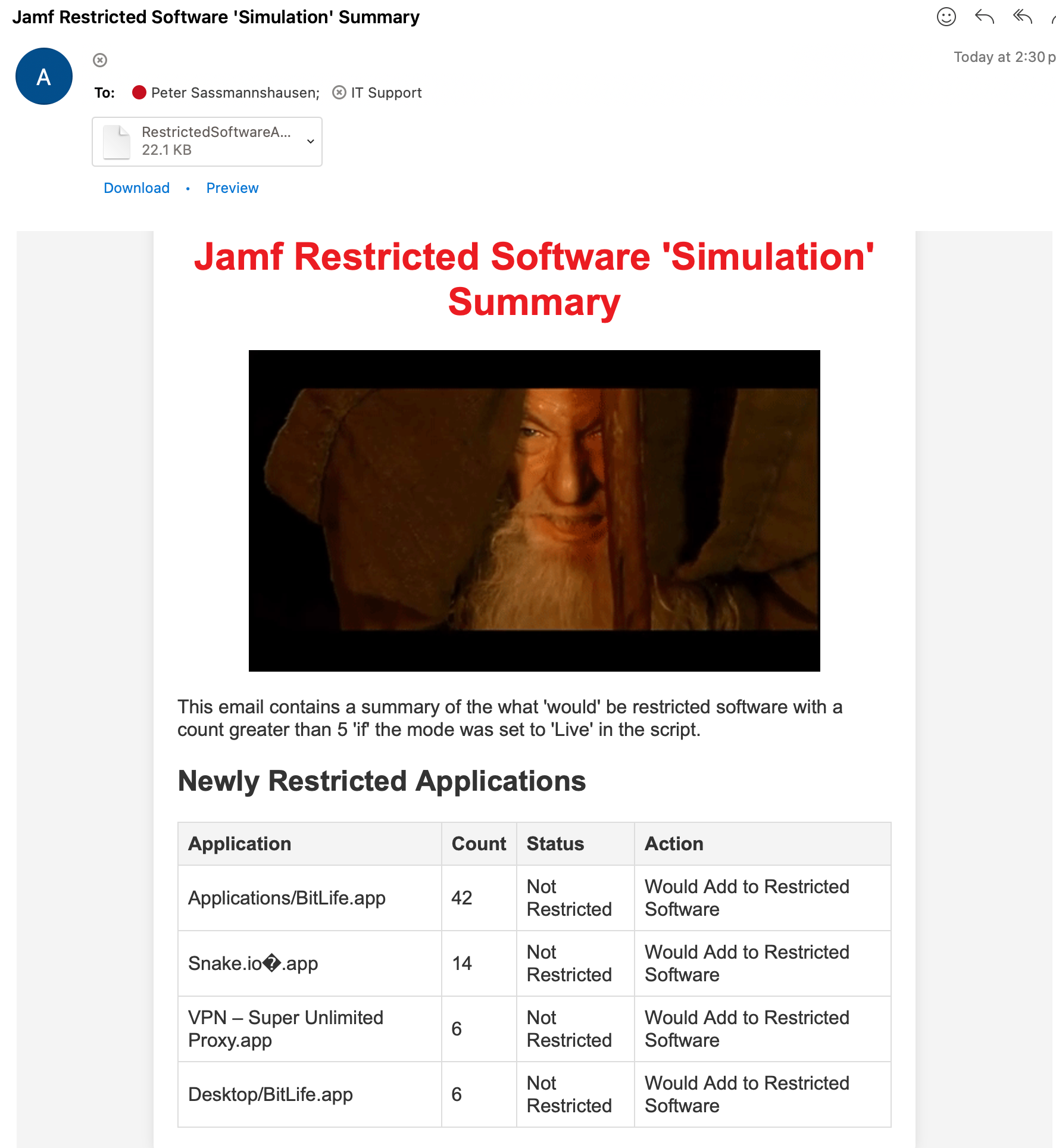

Email Notification Example
Below is an example of the email notification generated by the script:
Subject: Jamf Restricted Software Summary
Body:
Includes a GIF or image.
Displays restricted applications in an HTML table.
