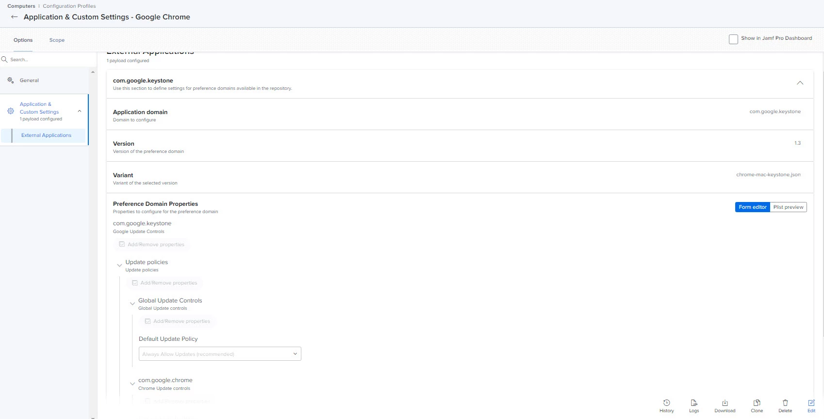

I push a Configuration profile to the Chrome browsers to force updates and we officially manage the Chrome Browsers so that is an option for you.

As others have said a configuration profile to enable auto update is the best option. However, if chrome is not running the auto updates wont run. So, if you have users that use a different browser than Chrome will never update. I usually sweep behind every 3-4 months and update chrome with a policy.

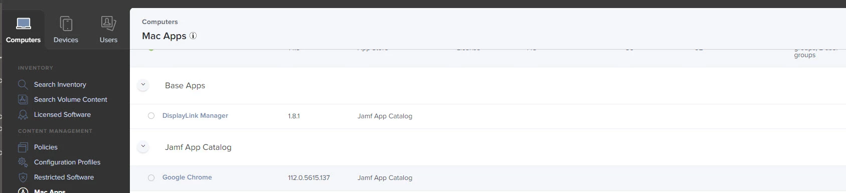

You can use patch management but then you have to package every new version.
Or you can use macapps jamf catalog and it will do the work for you.

Does it have macapps jamf catalog?

But you should still have a configuration profile for chrome just to make sure it is set auto update.
