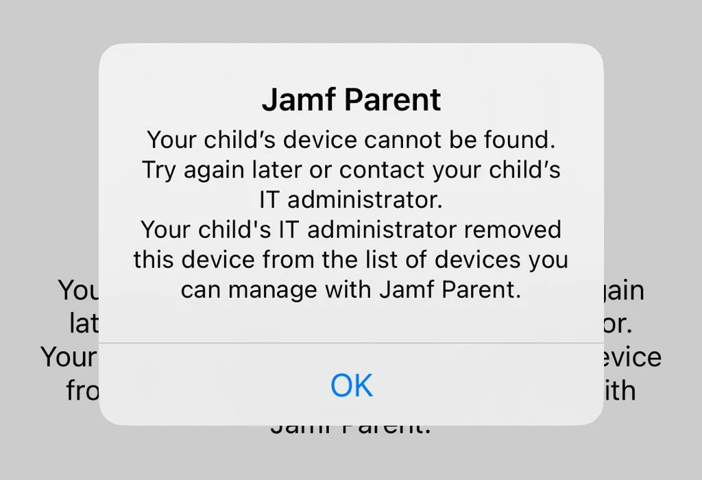

I tried to enable JAMF Parent, but when scanning the QR Code within Self Service from a parent device, I get "An Error has occurred. Device has been removed, please contact your school IT admin". I followed all instructions here: https://learn.jamf.com/bundle/jamf-school-documentation/page/Jamf_Parent_Integration_with_Jamf_School.html
Is there anything further that I need to do? Parents have apparently been trying to control their children's iPads, however they get this error and I am not removing them.

the message shows that the device is not controlled by Jamf school. So at first, make shure the kid did not leave the device management, if you addet the device via QR code or link to Jamf school or via Apple Configurator and the kid did leave the management under VPN in the 30 day period it will look managed in Jamf school but its actually not.
If it is managed and cant controlled via Jamf parent, try to reset the device in Jamf school and retry it. A bad suggestion but 90% success rate in most of the cases.

Hi MIB, thanks for your input.
This device is 100% under Jamf School Management and is in DEP, I wiped it and added back to Jamf School 3 days ago and have complete control over it via the Jamf School web UI via my admin account. I can unlock, send commands, etc. The child goes home to their Dad, he uses his phone with Jamf parent app, scans the QR code, the device shows on the app. He clicks on the device and then the message says that it has been removed from their management by an admin and then the phone disappears off the app.

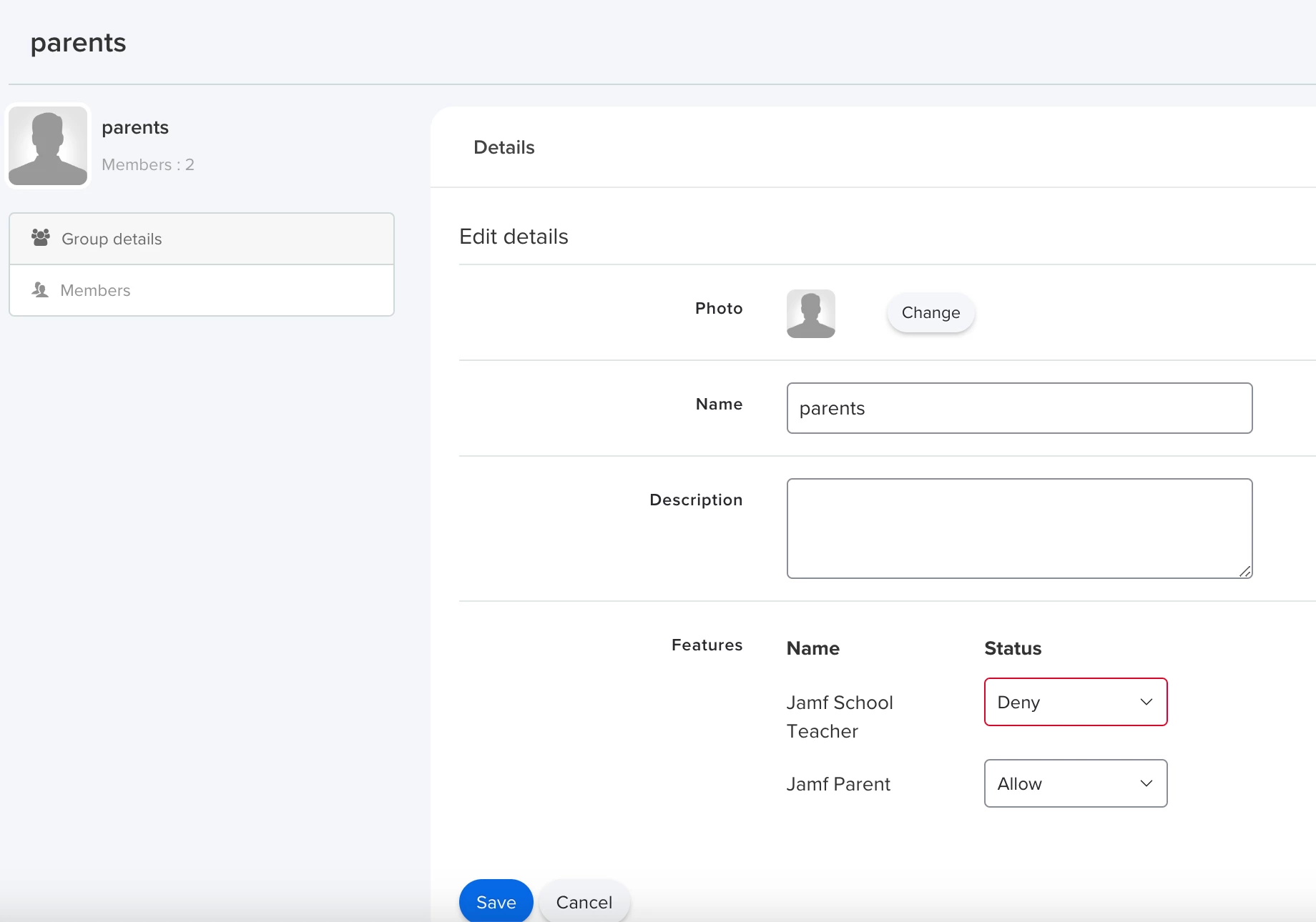

In order for Jamf parent to work, you need to have a user group called parents with the Jamf Parent feature set to allow.

I am having the same issue now. I can confirm that I have a parent group set up with allow set for Jamf parent and that the device is being managed in Jamf School and that it has the profile applied and the Jamf Student app installed and running. Any thoughts on what else I may need to do to get my parents the ability to control their child’s device outside of the school day?
