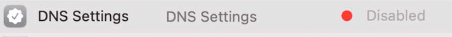

I have the issue that  When the DNS settings disable I am able to login CloudFlare WARP client
If the the DNS settings enable, i can not login the CloudFlare WARP client with the error message "CF_DNS_LOOKUP_FAILURE." and here is the solution

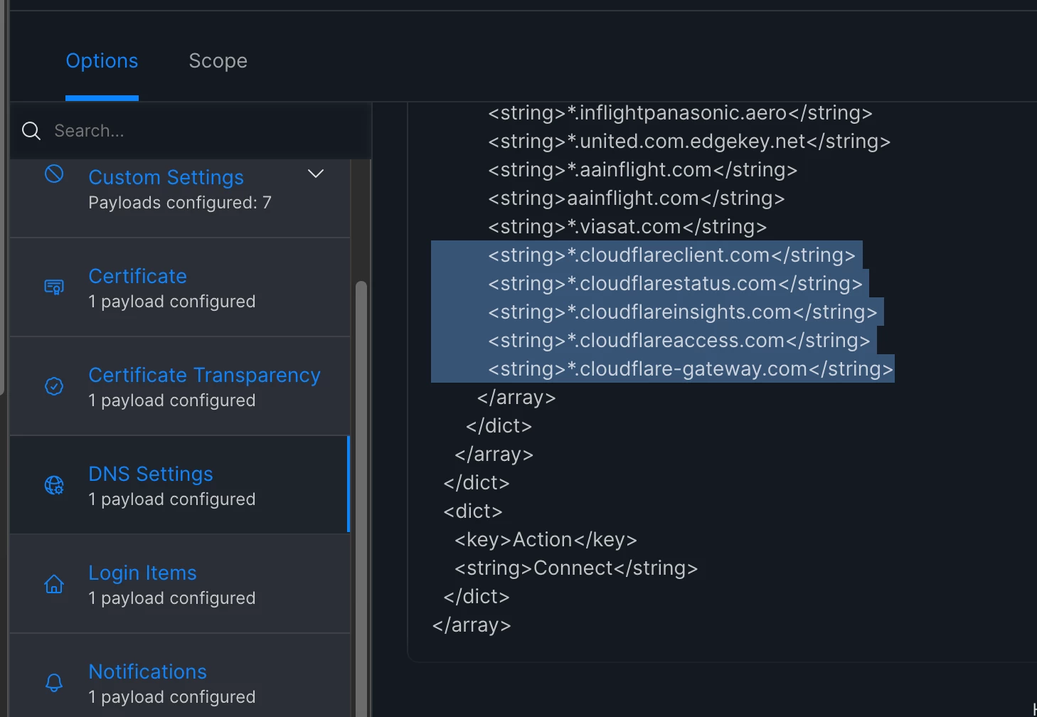

I already tried to bypass these domains without help in configuration proflie
<string>*.cloudflareclient.com</string>
<string>*.cloudflarestatus.com</string>
<string>*.cloudflareinsights.com</string>
<string>*.cloudflareaccess.com</string>
<string>*.cloudflare-gateway.com</string>

I know this is late but for future reference this issue can be solved by editing the Jamf Protect Activation Config Profile you get in Jamf from Radar (Security Cloud). The profile has a DNS settings payload, click it and on the right side you have a section called On-demand rules the under section DomainAction/NeverConnect/Domains you need to add <string>connectivity-check.warp-svc</string> at the bottom of that list. Once you do that and redeploy the profile to your machine and Warp should connect.

Thanks for posting. I can confirm that this worked! We have a client who requires the use of Cloudflare WARP, and this worked for me on macOS 26.
