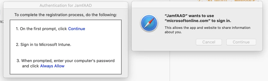

markopolo
Getting this on some (but not all) of our Intune registered Macs that looks like it's coming from JamfAAD. Nothing triggers it that I can tell, totally random. We recently went through registering everyone in Intune and saw a similar message at the end of the procedure (when JamfAAD launches), but everything had been fine since then. The only thing that changed was we upgraded JSS to 10.25 last night and we changed the Intune connector this morning from Manual to Cloud Connector (which was pretty seamless). Anyone know what could be causing this?

I get something similar. It looks like yours is using a custom page. Unless I'm mistaking this for something else. It pops up constantly and signing in doesn't make it go away. Registration works. We haven't rolled it out to all Macs yet thankfully. This would be really annoying for users. No solution yet for my issue.

@hdsreid it does not have anything to do with iOS Device Compliance. That is a separate set of Enterprise Apps that do the server side (Graph API) and client side (Authenticator app) call outs.
@whitebeer is correct that the reason this is taking place is due to the change in the MSAL library that is used for authentication. In Jamf Pro v10.24 and up the library was updated to v1.1.2. On Jamf Pro v10.21 - v10.23 MSAL v1.0.7 was in use and it did not require the ASWebAuthenticationSession to be launched (the prompt that macOS is giving to redirect to Microsoft for login).
The pop ups ARE expected in the case of say a new registration where a token does not already exist for authentication, and they would be expected in the case of a password change or session expiration (Global default from AAD is 14 days out of box but can be changed). In all other scenarios (EX: Monday the 4th to Tuesday the 4th where the Mac was on and the user used it both days and did not change their password and the session was not expired) it should not prompt.
What I am working to determine is why for some macOS clients does the silent token auth. that MSAL does on daily checks (that the jamfAAD Launch Agent does (more on that here)) fail to stay silent when it should be.
In a number of logs I have been looking over we can see examples of this.

An update for anyone following this thread. We have been working with Microsoft's MSAL team on these errors we are seeing.
The large majority are NSURL error of network failures ranging from timeout to DNS name resolution. When the MSAL silent token authentication in the background fails jamfAAD is taking that MSAL exit error and falling back to an interactive authentication the same as it would for a missing token or expired session before. The catch being that now with the new ASWebAuthenticationSession that has to be launched (the prompt that macOS is giving to redirect to Microsoft for login) and is very in the users face.
From the several dozen sets of logs from devices I have looked at ~85% of the time it is down to a network failure. The new WebKit based authentication must just be more temperamental than the previous style in old MSAL and ADAL. Also, as we found some end user clients that are work from home on high latency networks (satellite internet) seem more affected.
