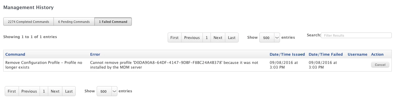

  • September 13, 2016
Hi, any advice ?
I'm manually installing a VPN configuration profile that was originally created and downloaded from the JSS, is there any way to convert it so that the error below does not occur ? i had a look at mcxToProfile, if i could find a way to convert the profile to a plist then use mcxToProfile to convert it back ?
I also had a look to see if it was creating a plist in /Library/Managed Preferences but nothing in there.
i'm manually installing the profile rather than pushing it from the JSS as once the profile gets installed from the JSS it falls out of scope and gets removed, i couldn't find another way to approach it

  • September 15, 2016
Downloading from the JSS and de-signing or re-creating did not stop the error message, as the JSS
is looking at the profiles UUID and even if deleted the record still exists in the database.
The approach i got to stop the errors
• Create and download configuration profile from JSS
• Delete the Profile from the JSS
• Make a back up of the JSS database
• Delete the Profile (Identify by UUID or name) from the JSS database, easy with Sequel Pro
as the profile no longer exists the JSS doesn't try and remove it.
