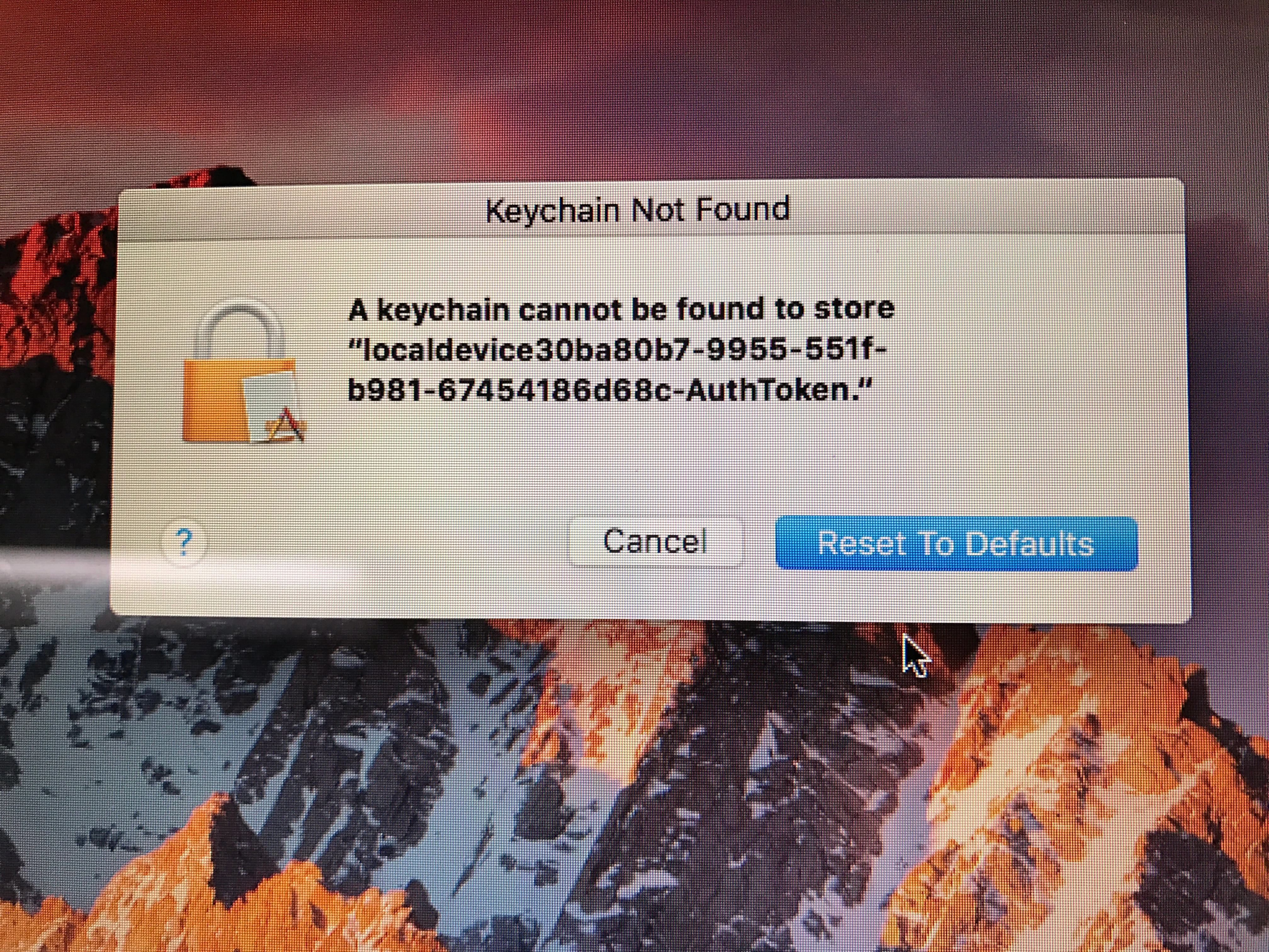

Since imaging with 10.9.5 and binding via the Apple Built-in AD Bind, when i login in as a new user, I get the following message: "A Keychain cannot be found to store "username"". Has anyone else seen this?

  • November 8, 2016
New to Casper, have imaged 30 MacBook Airs (shared machines at a primary school in a computer lab) with Casper Imaging but received the "keychain cannot be found to store" error but only when logging in with an AD account. Using one of the local accounts works fine.
I've used FUT and FEU for Firefox, Chrome, and Office 2016.
I know someone mentioned the solution is to go through package by package, but how exactly? Does this involve having to re-image the machines? I used FUT and FEU to customise the settings for the apps, mainly Firefox.

@Wheelspinning I would suggest taking a test machine and image it using the same configuration you used on the 30 MacBook Air computers but leave out any installations that have FEU/FUT set on the package. If you don't get the keychain error then you can add back one package at a time and test to see if you can figure out which package is causing your issue. Otherwise you could try posting screen shots of the Composer packages for Firefox, Chrome and Office and maybe we can figure out from those what might be causing your issue.

Thanks @mpermann
I imaged a machine with just the base OS and AD binding and the error went away. I will try loading the other apps one by one and see which app is the problem, but for now happy without the error on the test machine. Won't be using AD until the start of school next year (Australian school year is calendar year)
