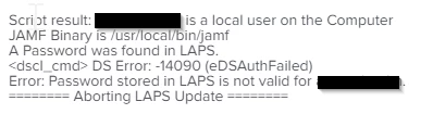

Hi,
We are using LAPSforMac/LAPS.sh at master · caffine247/LAPSforMac · GitHub for LAPS rotation however this script is not working on macOS Big Sur or Monterey.
Here is the error message:
Just wondering if someone has an alternative or fix for this ?
Thanks!

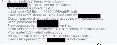

That's what I had on my on script.  Issue is line 165 - "passwdA=`dscl /Local/Default -authonly $resetUser $oldPass`"
I can't verify password locally either.

I appreciate your help with this issue. The script has all the values as you have mentioned in your last comment. I did more investigation and found that LAPS user's secure Token status is disabled. From research I did there is no possibility to enabled unless I know the password for LAPS user.  Script is not able to use default password to do authentication. Here is our current workflow
-All our Macs are DEP enrolled. During prestage, we create a local admin user
-Once onboarding is completes. On check-in, default password used in PreStage is used to rotate LAPS password which is failing
