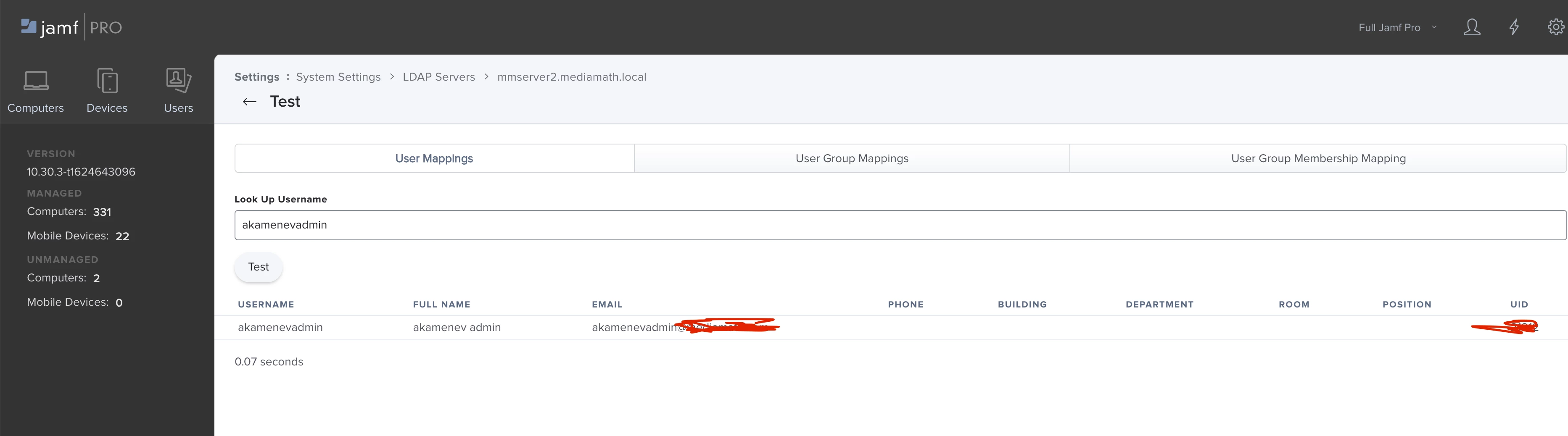

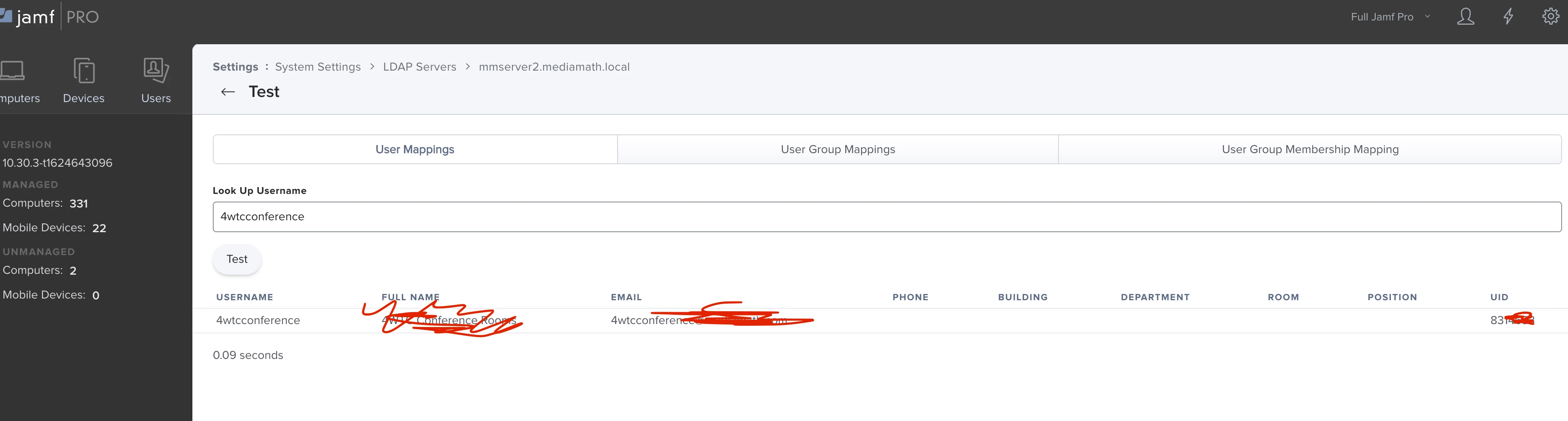

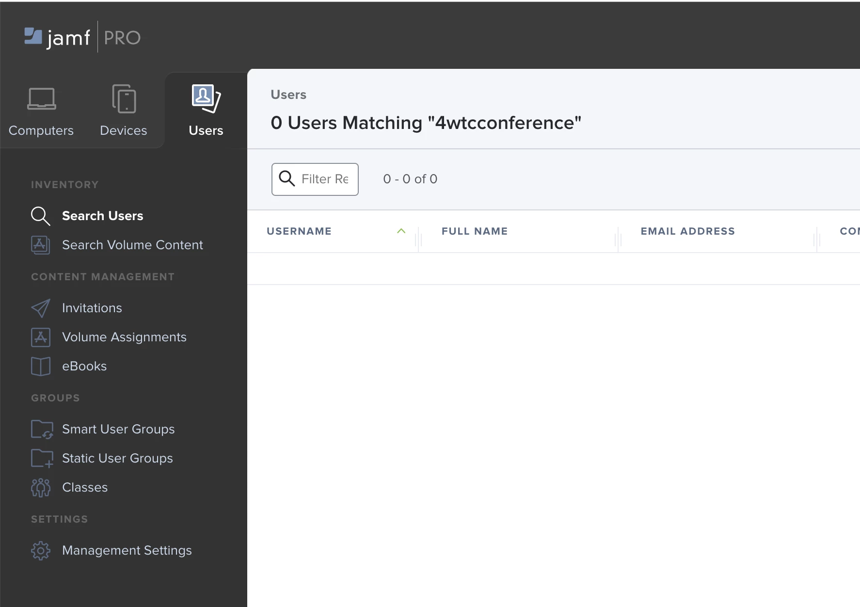

I am having a strange issue, where I can find the user account under LDAP > Test feature, but it does not find that same account under Users on JSS... Anybody seen this before?
I can find another account in both: LDAP > Test and under Users, which are located in the same OU on the AD, but this particular one I can't, which doesn't make any sense...
Appreciate any suggestions on this!

@akamenev47 has that account enrolled a Computer or Device in Jamf Pro, or been assigned as the user for one? If not they won't appear in Users yet. Searching users doesn't do an LDAP query, it's just a search of the users assigned to a device enrolled with Jamf Pro.

For example, my admin account is found at both locations...

Thank you so much, I had no idea about this!
