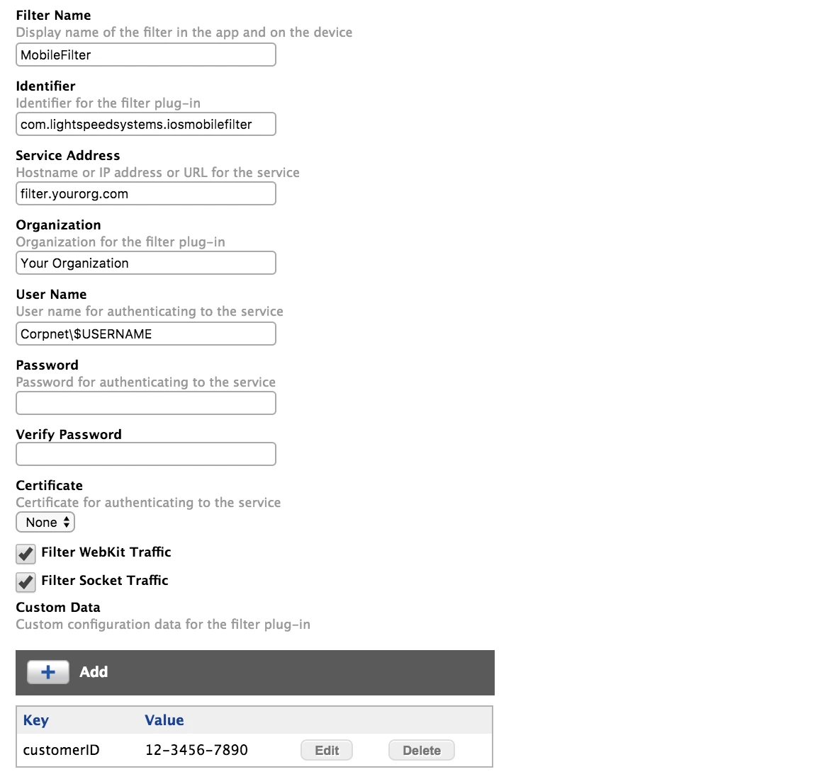

Can anyone offer any insight on this? What is everyone that got it working putting in the Filter Name and Identifier fields? I seem to be able to get every site "restricted" (not by a Lightspeed page), or no sites filtered at all.
  • Jun 26, 2017 11:27 PM UTC
Kempt,
I have been going through a new deployment at our school. I will provide what we have been doing as far as settings configuration below just plug in your appropriate info. Also ensure that the Mobile Filter iOS app is installed through the MDM as a managed app and has been opened once on the device being filtered. If the configuration profile is installed, you will see your organization name, unique ID, filter address, and app version when the app is opened.

  • Jun 27, 2018 7:45 PM UTC
@chris.miller
For our iPads I have performed the following:
- Created a configuration Profile
General:
-- Name: CPA-MS-2025-Proxy
Certificate:
-- Downloaded Certificate from Rocket and place here
Global HTTP Proxy:
- Proxy Type: Automatic
-- Proxy PAC URL: (Your Proxy PAC URL here)
-- Allow Direct connection if PAC is unreachable = checked
Content Filter:
-- Filter Type: Plug-in
Filter Name: Whatever you want the name to be
-- Identifier: com.lightspeedsystems.iosmobilefilter
-- Service Address: Your hostname or IP Address of your Rocket
-- Organization: Name of Orginization
-- User Name: domain$USERNAME
Custom Data
key: value:
customerID (I found this information in the device registration portal, http://mobile.lsfilter.com/ )
Note: For the USERNAME to function properly you will need to populate the username filed on the device under User and Location.
Once the app is installed you will need to launch it for it to fetch the settings and register in the device registration portal.
I hope this helps.
