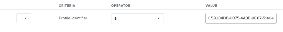

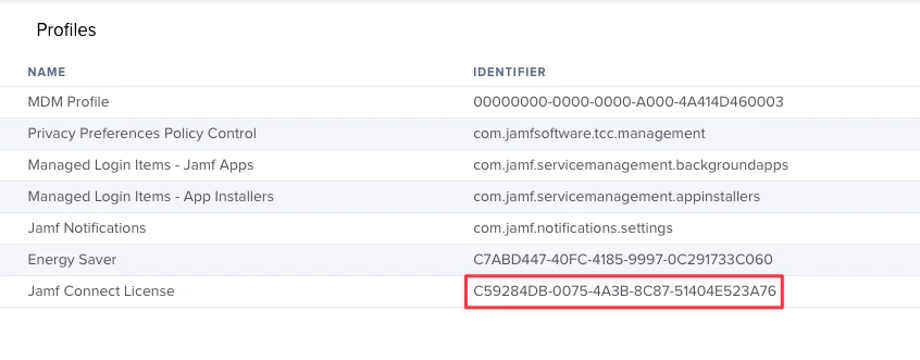

Sure. I always use the Profile Identifier for Smart Groups since that should not change unless the profile is deleted and a new one is created. Where the name of the profile can be changed and that could affect Smart Group membership (ask me how I know... ;-) ).
  1. Deploy the profiles you need to watch for to a test machine. This is a test device that is enrolled in Jamf Pro.
  2. Go to the device record in Jamf Pro and look at the list of Configuration Profiles installed on the device.
  3. Copy the Profile Identifier for each of the profiles you are watching for:
  4. Create a Smart Group that looks for the presence of the profiles (you can create one group to look for both profiles, or two groups; one for each profile). The criteria is Profile Identifier:
  5. Use  the Smart Group(s) as scope for your SentinelOne Policy.
This will give you a positive group, meaning all devices that have the profile.
In the above example that Smart Group criteria would be looking for devices that have my Jamf Connect license profile installed.
