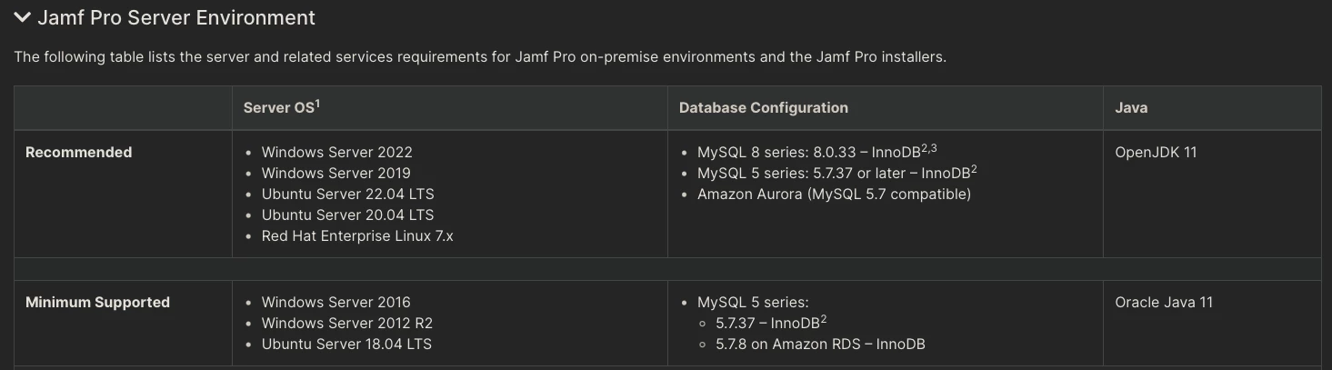

dammm seems like Linux 8 is not supported:
https://learn.jamf.com/bundle/jamf-pro-release-notes-10.50.0/page/System_Requirements.html
I will try with Oracle Linux 7 which should be supported.

Ubuntu is supported. Why not use that instead? Before I started my current job, I ran 8 on premise Jamf Pro servers on Ubuntu. None of them ever had an issue like this. My favorite Linux distro is CentOS. Jamf Pro will run on it, but I always ran Jamf Pro an officially supported Linux distro to avoid having Jamf tell me something isn't working because it's not a supported version of Linux. Oracle Linux is not listed as a supported server OS.
  • Nov 7, 2023 10:54 PM UTC
the problem is Linux 8 version vs 7 - they support RHEL 7 which is same sh.... as Oracle Linux 7. I dont use Ubuntu. I use RHEL Oracle Linux
  • Nov 7, 2023 10:56 PM UTC
And yes I installed jamfpro script on Oracle Linux 7 and it worked like charm. But version 7 is reaching closely EOL. So I will wait for 8 fully supported. Does not make sense the change CEntos 7 to Rhel 7 or Oracle Linux 7 where they EOL at the same time.
