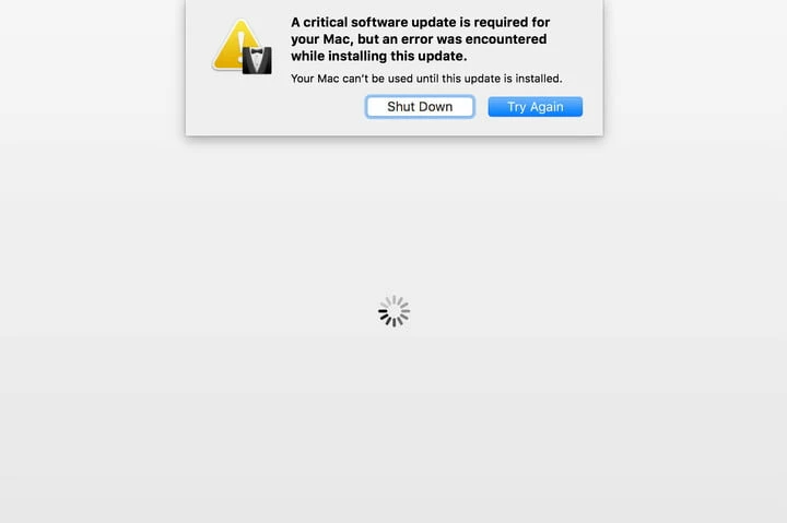

macOS will show an "Urgent software update required, please connect to the internet to continue" warning message when you try and bypass the activation phase that way. Back in Catalina, it looked like this:
During activation, the Mac is checking for both Activation Lock status and for automated device enrollment information. If it isn't able to reach Apple's activation servers, it will thrown an error and require you to attach a working network connection. Then again, this may only be the case with models with the T2 or M1 chips, I haven't actually gone back to test this on older models.
