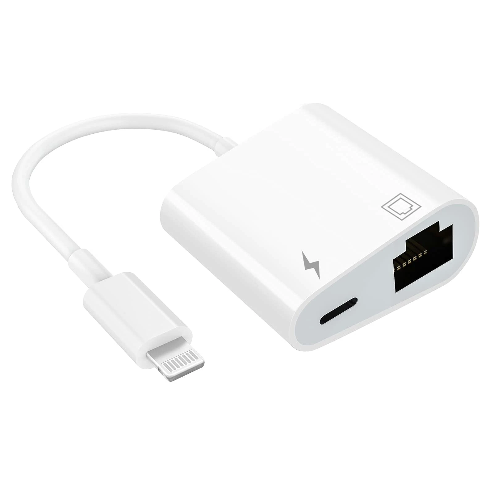

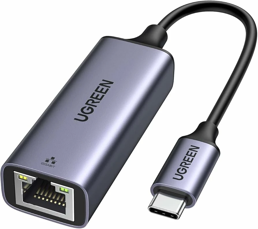

Here are the adapters you must have:
Lightning to Ethernet ( iPad gen 9 and below )
Usb-C to Ethernet ( iPad gen 10 & iPad Pro )
just a little addition that makes the iPad faster to connect to the internet and the disable lost mode command can be accepted by the iPad,
After you plug the lightning into the ipad and the ethernet port into the Ethernet cable, Hardrestart your ipad
