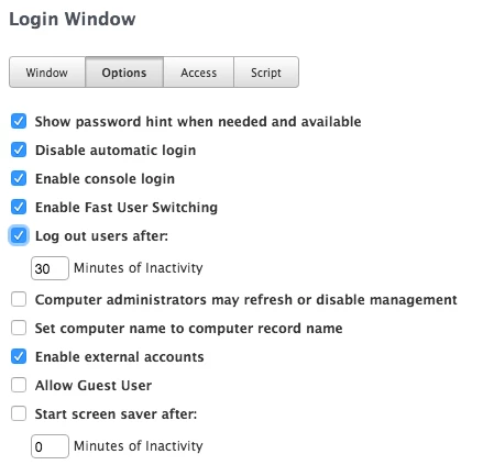

Ive noticed that some of our machines start this new behavior that they logout after 30 min of inactivity and it sets itself automatically in security and privacy setting. I did not set this up and I can not find anything in the policies or in configurations. Had anybody else has this problem?

Hi popakr,
I had this discussion just today on the MacAdmins Slack group, answered by hkabik. They were able to answer my question which was the same as yours.
The issue is if you have a Configuration profile for Login Settings, I believe under Casper versions above 9.8, it ticks a box within it that results in machines logging out after 30 minutes as described above.

Hey all,
This is a product issue (D-009686) we are aware of and hope to include a fix for this in our next release 9.82, which is currently in beta.

Hey @dferrara,
D-008560 was an issue where any amount of time set with the profile did not work, this was resolved in 9.8.
D-009686 which I mentioned above relates to how it automatically checks the box to log out the user after 30 minutes when the JSS is upgraded to 9.8 or later.

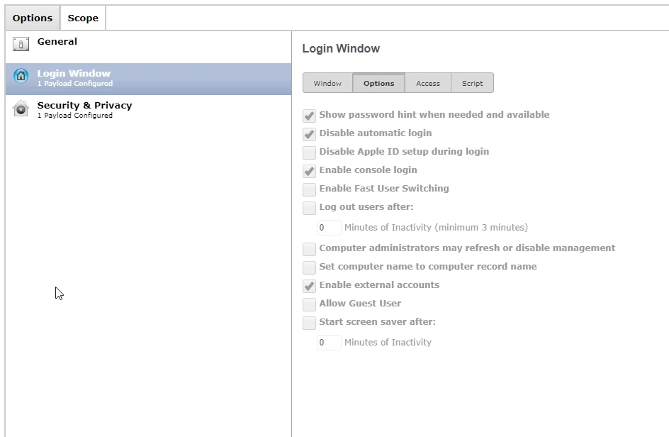

Our config profile is unchecked for the auto logout setting. This works on almost all of our 400 machines. However, we have 4 or 5 that seem to be overriding the profile and keep auto logging out. We have wiped these machines and the problem will come back as soon as they check into the JSS. We are totally stumped. I'm starting to think there is a setting at the user level that is causing this, although the users are not admins on their machines....

this is what resolved our issue:
Try combining two payloads "Login Window" and "Security & Privacy" on one configuration profile...

I also have a couple of Macs where users report going to lunch and come back to find their workstation completely logged out. I have Login Window configured and verify that auto logout is unchecked. I have also removed framework and re-enrolled the devices but that did not resolve the issue. Running version 9.99.0-t1494340586. I have tried osxadmin's suggestion to combine Login Window and Security & Privacy payloads, and will see if that fixes it, but it is a little frustrating that I am not seeing the config setting reflected in the workstations behavior.
*UPDATE - After combing the two payloads Login Window and Security & Privacy, as osxadmin suggested, the problem is resolved, and the logout after 30 minutes box is not be re-checked when user logs in. Thanks!

I'm having this issue on 10.15.7 Macs, and the configuration profile I have tested is not working to prevent this. My CP looks just like the one osxadmin posted. Is anyone else experiencing this issue?
When the log out box after box is unchecked, it keeps getting checked again.
