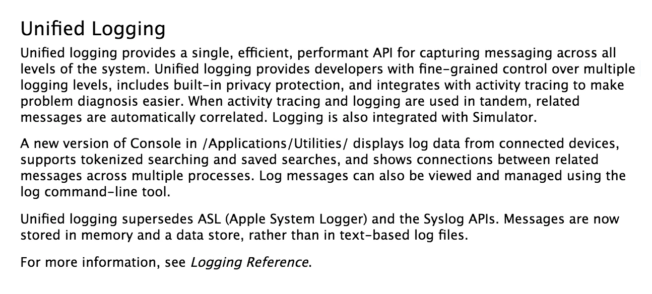

What's New in macOS | macOS Sierra 10.12
Did some digging last night, found the default might be stored here as a TTL DEFAULT value:
# defaults read /System/Library/Preferences/Logging/Subsystems/com.apple.mac.install.plist
    BridgeOSInstall =     {
        "Default-Privacy-Setting" = Public;
    "DEFAULT-OPTIONS" =     {
        "Enable-Oversize-Messages" = 1;
        "Event-Log" =         {
            Enabled = Inherit;
        Level =         {
            Enable = Info;
            Persist = Info;
        TTL =         {
            Default = 30;
    EmbeddedOSInstall =     {
        "Event-Log" =         {
            Enabled = 1;
    EmbeddedOSSerial =     {
    OSPersonalization =     {
Haven't yet come up with a way to change TTL value.
