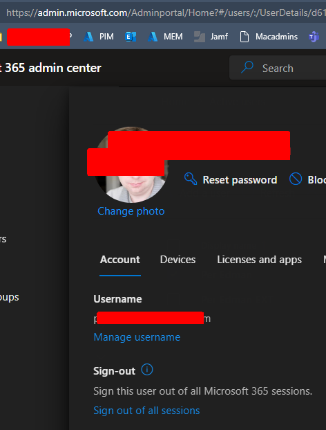

piotrr
  • Oct 16, 2023 12:54 PM UTC
I sign their sessions out from Office 365 admin instead... That way it doesn't matter what their computer thinks, they aren't logged on.
Active users - Microsoft 365 admin center
