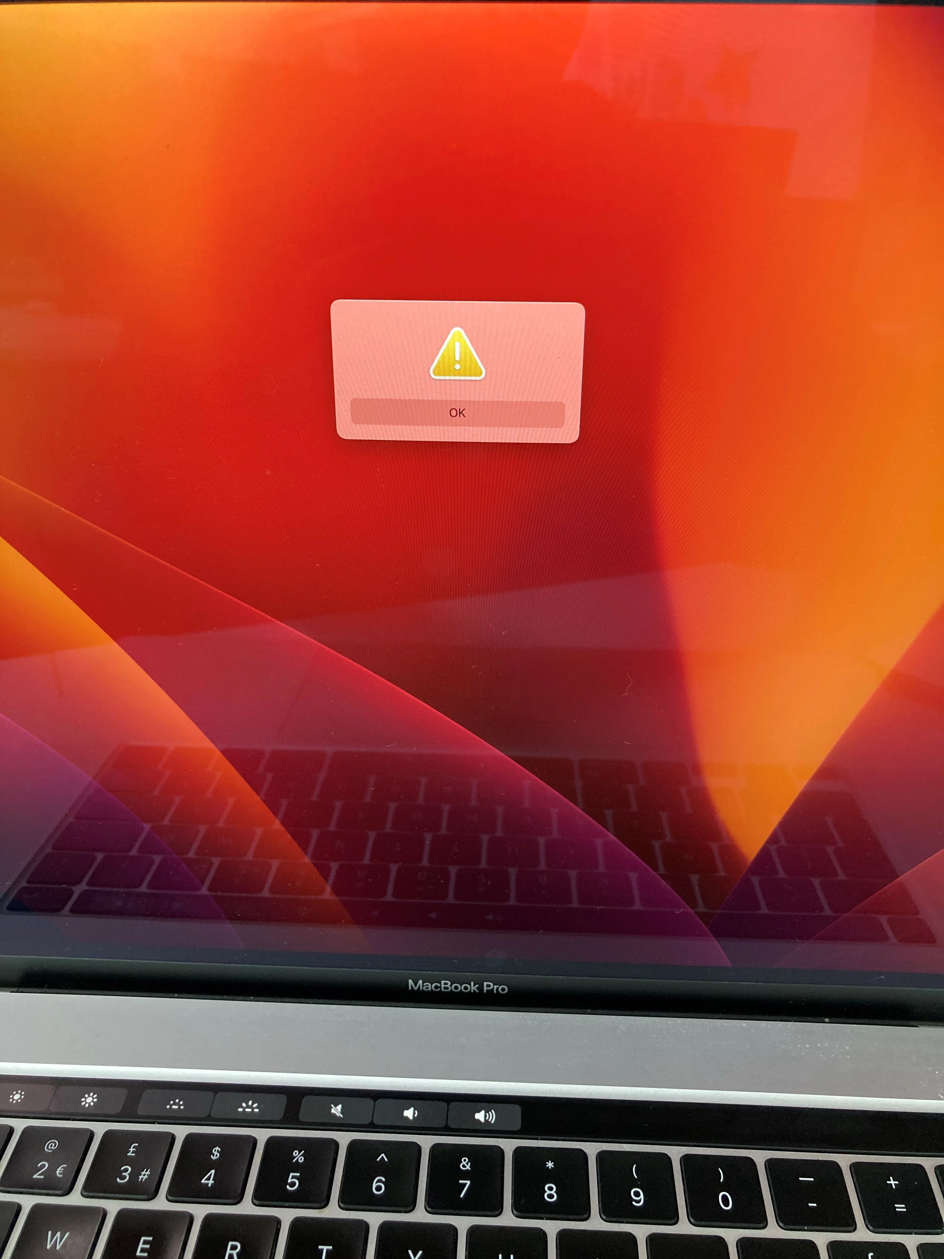

Hi Peeps,
I'm having an issue with this login window, and I can't find any solution for this particular issue.

Hi @AitchySan,
Let me give an insight about what I'm going through,
I have a new machine that needs to enrol in jamf pro, but after the enrolment  I've got the Yellow Exclamation mark and says "We are creating your account". When I click on the "OK", and the screen goes off, and restart.
Should I remove the Local Account creation in the PreStage Enrollment? I will try to do it without using any policy and see what's going on. I will keep you posted.
iOS version : Ventura
Jamf Connect : 2.24.0
Maybe it could be an issue with the latest Ventura and I'm also having a flickering screen. I wonder if it is normal.

Jag - this is very similar to us. what version of ventura are you on? my machines are 13.5.2 - my other test machines didnt do this though and its possible they were 13.5.0. im potentially going to test this. i contemplated removing local account creation. are you using jamf connect? if so we could compare jamf connect plists? im also trying to find a log that might give an insight into account creation... cheers

Im starting to wonder if this is a network issue... our wifi connections are notoriously bad for dropouts, and my test mac is now working ok. so it worked fine on first login, then it broke after the next logon, then after another restart and reconnection it seemed to work again. it seems very odd. when it actually logs in ok, everything looks fine.

We just experienced this today on three macs simultaneously! Upgraded Jamf Connect from 2.22 to 2.27 as well. No issues making new accounts. Issues persists. So currently resorted to deleting and rebuilding the account.

Thanks for keeping me posted @AitchySan , and mine was different issue.
There was a missing group from my AAD's account and now the issue has been resolved.

Affected users are in the AAD group used to authenticate into Jamf Connect OIDC app, as well as the group used for the compliance partnership in intune.
UPDATE: deleted user profiles doesn't help. Wiping the Macs seems to be the only resolution.

Yep this is happening on Ventura so far. Wiping the Macs didn't help the issue. On with Jamf support chat now.

We just resolved this issue. This was due to the EntraID as OIDC Provider in Jamf connect requirement for version 2.27. However, this affected our Macs on Jamf Connect 2.22. So, my takeaway is to immediately update everyone to Jamf Connect 2.27 and deploy the modified config profile with the "EntraID" as the OIDC Provider as opposed to "AzureAD".

Link - Sorry, Automated device enrolment. the prestige enrolment basically a Mac coming from a factory state going into enrolment out of the box. what I found was my manual enrolments were working fine, but my automated enrolments were not. as mentioned above I noticed each of these 2 deployments had different versions of swift dialogue. after I switched to the older version of swift dialogue the problem went away...

Below is my com.jamf.connect.login, configuration profile.
<plist version="1.0">
<dict>
<key>AllowNetworkSelection</key>
<true/>
<key>BackgroundImage</key>
<string>pathto.jpg</string>
<key>ChangePasswordURL</key>
<string>https://account.activedirectory.windowsazure.com/ChangePassword.aspx</string>
<key>CreateJamfConnectPassword</key>
<true/>
<key>CreateNewUserHide</key>
<true/>
<key>DemobilizeUsers</key>
<true/>
<key>DenyLocal</key>
<true/>
<key>DenyLocalExcluded</key>
<array>
<string>admin1</string>
<string>admin2</string>
</array>
<key>EULAText</key>
<string>This computer system and all data and information associated therewith, are the property of the Company and for authorized use only.</string>
<key>EULATitle</key>
<string>Welcome to Company</string>
<key>EnableFDE</key>
<false/>
<key>LocalFallback</key>
<true/>
<key>LocalHelpFile</key>
<string>/usr/local/jamfconnect/help.pdf</string>
<key>Migrate</key>
<true/>
<key>MigrateUsersHide</key>
<array>
</array>
<key>OIDCAdmin</key>
<array>
<string>Administrator</string>
</array>
<key>OIDCAdminAttribute</key>
<string>roles</string>
<key>OIDCClientID</key>
<string>*clientid*</string>
<key>OIDCNewPassword</key>
<false/>
<key>OIDCProvider</key>
<string>EntraID</string>
<key>OIDCROPGID</key>
<string>*ROPGID*</string>
<key>OIDCRedirectURI</key>
<string>https://127.0.0.1/jamfconnect</string>
<key>OIDCTenant</key>
<string>*Tenant*</string>
<key>OIDCUsePassthroughAuth</key>
<true/>
<key>ROPGProvider</key>
<string>Azure_v2</string>
<key>ROPGRedirectURI</key>
<key>ROPGTenant</key>
</dict>
</plist>

this would appear to not be resolved. im still getting this despite consistent good logins. i have tried changing the jamf connect script references from azure to entraid, still the same. i have tried varying versions of swift - still the same. i just did a new build there and it breaks on first logon. the only consistency is that as soon as it gets to "creating your account on this mac" it gives the error msg of "OK" with the exclamation, and then. black screens. its so inconsistent its unreal!!

Please check the required user if he/she is the correct group in AZURE, for mine was resolved, by adding the user to the correct group in Microsoft-Azure Portal.
