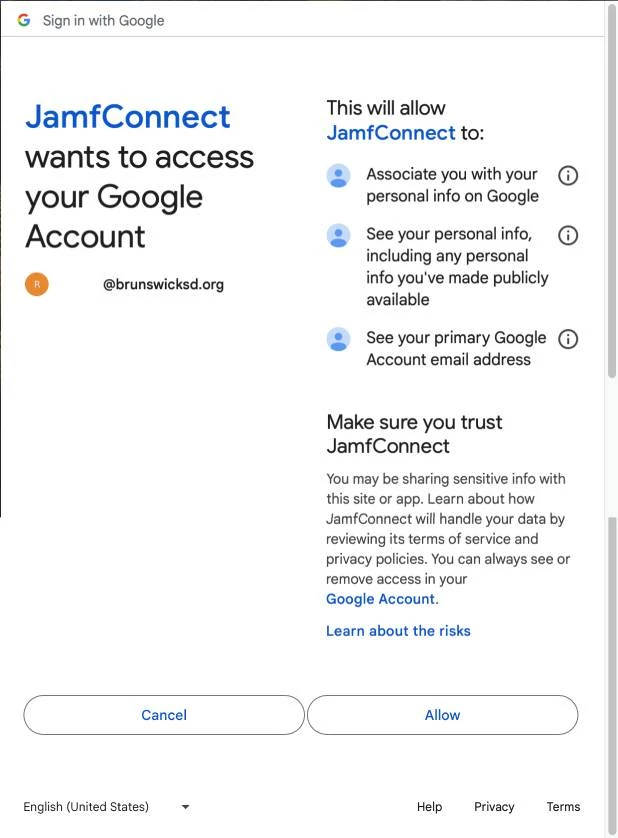

rosmer
Suddenly, as of a few days ago, users are prompted on every login to allow Jamf Connect to access their Google accounts. They need to scroll down and click Allow every time.
The only thing that's changed recently that I'm aware of is that Jamf Connect version 2.35 went out just before the issue appeared. I tried rolling back on a test device with no luck though. Laptops are all on at least 14.4.1 of Sonoma.

Best answer by rosmer
I have a fix, but not a great one. It at least points to where the issue is.
If you followed Jamf Connect's guide to integrating with Google then you entered https://127.0.0.1/jamfconnect as the Authorized redirect URI when setting up the OAuth Client ID.
Through a bit of a trial and error I've found that the OAuth Consent Screen does not like IP addresses anymore in the Authorized Domains section. I changed the URI to a fake domain address, like https://jamfconnectloginscreen.com, and changed it to match in the Jamf Connect Login Settings config profile in Jamf, and now I no longer get the consent screen.
I did this on a test setup because using a fake domain doesn't seem like a good idea long term. I don't know if any credentials actually get sent out to it.
I updated my ticket with Jamf in hopes they can figure out a proper fix.

rosmer
  • June 5, 2024
No progress for us yet. JAMF is waiting on info from Google while looking into it themselves, and Google has so far given no help. The only suggested action was to add the Oauth Client ID as Trusted in the API section of Google Admin, which we have done multiple times.
Google wants to get a HAR file (https://toolbox.googleapps.com/apps/har_analyzer/) but since JAMF Connect is not logged into through a traditional web browser I don't know how I could collect those logs.
rosmer
  • June 10, 2024

rosmer
  • June 11, 2024
In Google Cloud - Credentials - Oauth 2.0 Client IDs is where Jamf Connect has you create an ID. Within that ID you have to enter an "Authorized redirect URI"
This URI is what has to be a domain name now, but it doesn't say that explicitly that I can see. This will automatically be added to the Oauth Consent Screen's Authorized Domain list, which does specify that it needs to be a "top private domain"
Whatever you choose to enter, you have to change the OIDCRedirectURI key in your Jamf Connect Login Settings config profile to match. I tried it now with our school's website domain and it seems to work ok. I'm still hesitant to push it for all users though as I'm not totally clear on what it's used for yet.
