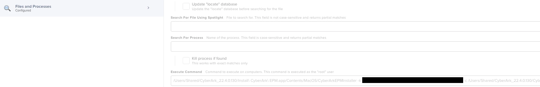

It's not what the "official way" but work for us on Monterey to Ventura with Intel or M1. I put the .pkg with the .config together in Shared folder. Create a .pkg with Composer and upload it to Jamf. I've tried different locations but failed. In the end, we decided using Shared. We use another product for password rotation, so we don't use the -u & -p.
In Files and Processes
/Users/Shared/CyberArk_22.4.0.130/Install\\ CyberArk\\ EPM.app/Contents/MacOS/CyberArkEPMInstaller -k Put Your Installation Key Here -c /Users/Shared/CyberArk_22.4.0.130/CyberArkEPMAgentSetupMacos.config; sleep 20; rm -rf /Users/Shared/CyberArk_22.4.0.130/
 use PPPC-Utility allow access SystemPolicyAllFiles
com.cyberark.CyberArkEPMEndpointSecurityExtension
As for System Extensions
*If anyone has better and cleaner way to do it, please let me know. Thanks

The zip file provided by CyberArk contains the .app and the .config which you need to run. I created a folder in Shared with both .app and .config > opened Composer > Dragged the folder in it > Created .pkg > Uploaded to Jamf > The policy contains the pkg and with the command above in Files and Processes. We only use the most basic flags to install, you can add others based on what you want

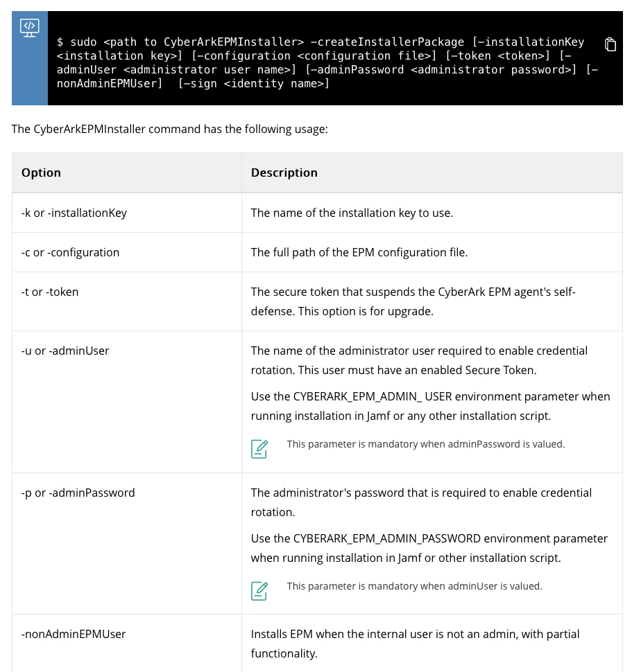

Unfortunately, our company requires the -u & -p commands to be present. But when I try to run it, it fails and gives this error...
janzaldua
  • December 19, 2022
I may have figured this out... I thought the 'secure token' it was referring to was a secure token provided by CyberArk. But it is referring to FileVault 2 enabled users... In order for the install to complete, FileVault 2 needs to be enabled for that specific user that is being targeted for the install.
After I enabled Filevault 2 for the local user account, the install works perfect. Although I still do get a popup asking to allow Terminal to administer the computer. I'm not sure how to get rid of that.
