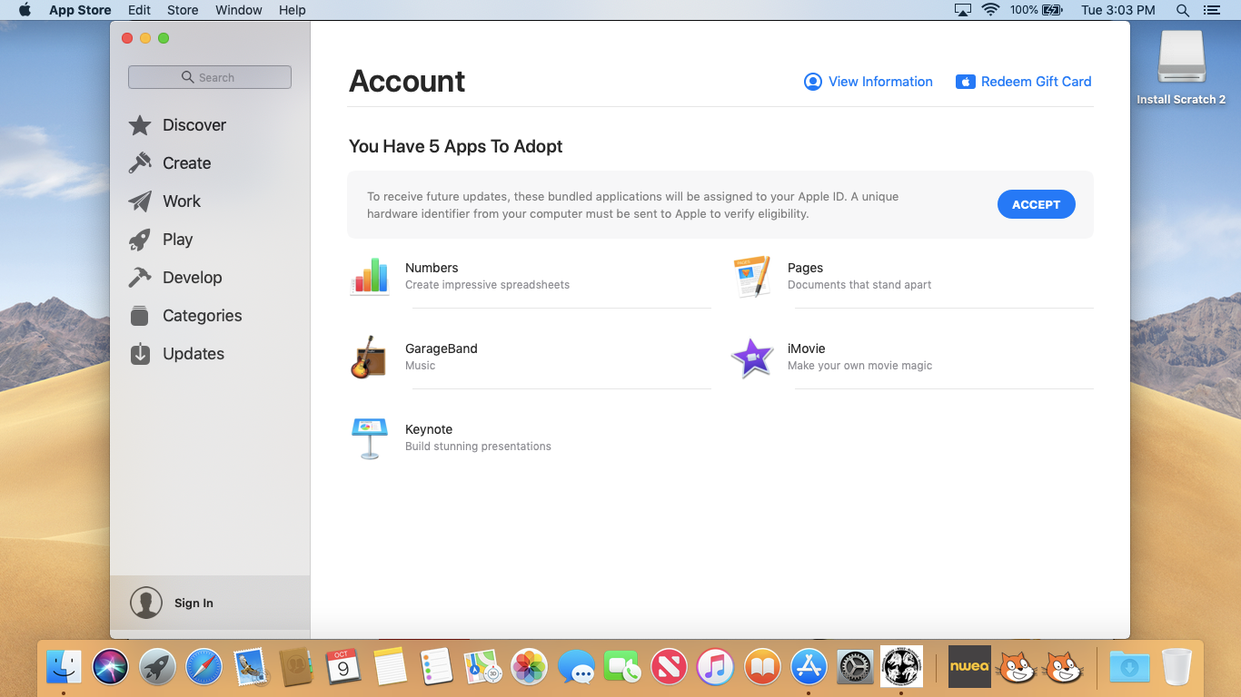

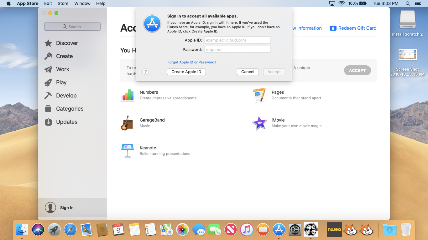

I am attempting the Mojave OS and see what breaks and what does not. All our devices have the VPP in JSS, we have over 2500 licenses available to us. We used to be able to launch Self Service and install MacApps like Numbers, Pages, Keynote, Etc. Since this update to Mojave it is once again asking for an AppleID on each device that needs the software.
Was there something I missed on how this is supposed to be seamless migration?
Two screenshots that show what I Am getting for a prompt. I figure come to "The Nation" first then to JAMF buddy.
Thoughts Ideas, anything to try?
  • October 9, 2018
I found that if you don’t make the Dep anrolment profile mandatory it will work I don’t know why but they need to be an admin to remove anyway
  • October 9, 2018
I was experiencing the same issues as everyone else. I remotely logged into my JSS server and ran the MySQL commands to repair and optimize the database. Once that was completed I was able to download VPP apps from Self Service with no issues.
