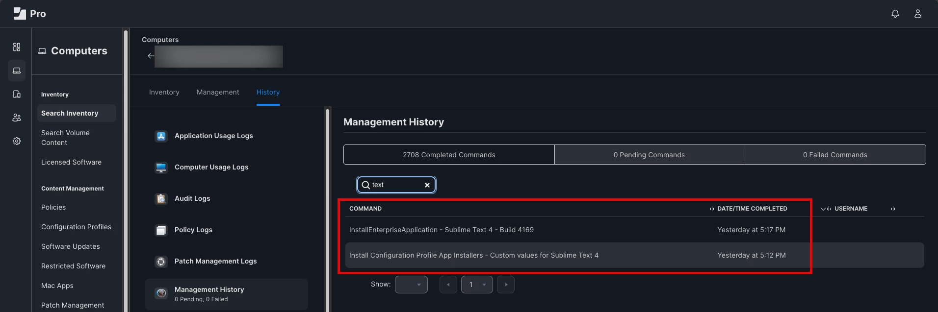

  • On the Jamf side the logs will be with the rest of the MDM Commands, and will consist of the app command, and the configuration profile. There may be more logging in the Jamf Console logs, I have never actually checked.

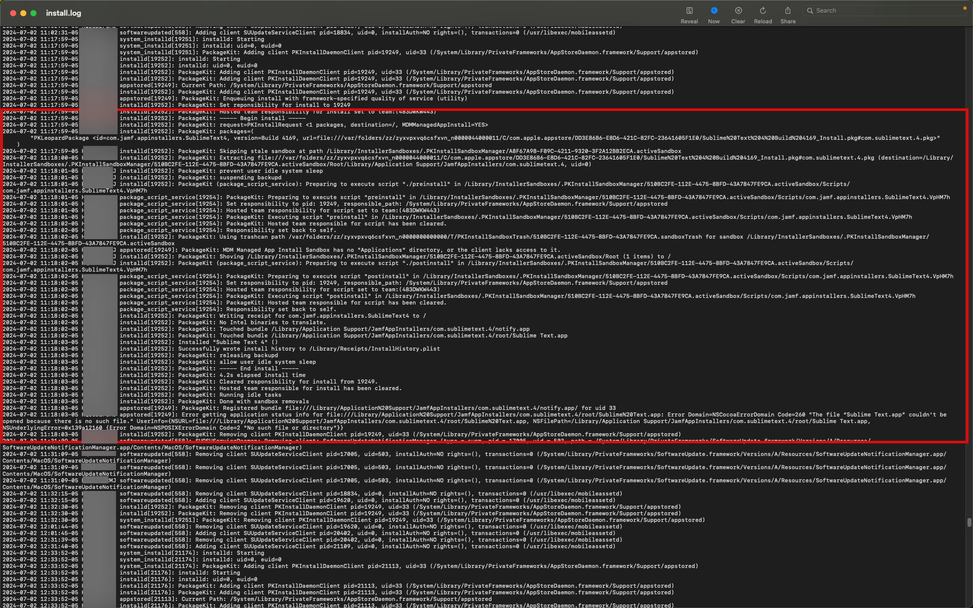

  • On the macOS side of things, it will be in /var/log/install.log. You should see the logs start with the typical ---Being Install--- and you will see the jamf app installers log a few lines later ("PKLeopardPackage <id=com.jamf.appinstallers.appName").
These are what the logs look like.
