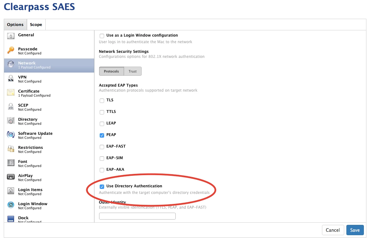

Did you enable "Use Directory Authentication"? That way the machine connects at the machine level and at the login window.

  • Nov 13, 2017 8:02 PM UTC
Where is "Use Directory Authentication"? I see "Use as a Login Window configuration" in the Network Payload.

  • Nov 13, 2017 8:11 PM UTC
It depends on your infrastructure, but we have this working in Sierra with the following settings using Cisco wireless:
In the Network WiFi Payload we use these settings:
-AutoJoin – Yes
-Hidden Network – Yes
-Security Type – WPA2 Enterprise
-Use as a Login Window Configuration – Yes
-Use Directory Authentication - Yes
Then we create an AD "User" that this profile connects to (with a PW that never changes). We isolate these down to rooms, but you could set these accounts up in a way that works for you. Macs don't support genuine AD 802.1x "computer" accounts in the same way that Windows does, creating this hurdle when you're first setting it up.
