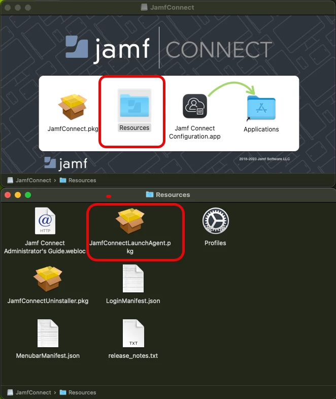

Have you deployed the Jamf Connect launch agents? This are what tell macOS to launch Jamf Connect when the device is turned on.

Once Jamf Connect updates the login screen, it should be a permanent change (mostly).
You need to check your configuration profiles to see if it is set to use Local Authentication by default is to True and if you have two separate configuration profiles, one for enrollment and another for after enrollment.
What I believe is happening is that an enrollment config is set to show Okta login screen and then once it goes to sleep, enrollment is considered complete and then switches to another configuration profile that displays the local login screen.
