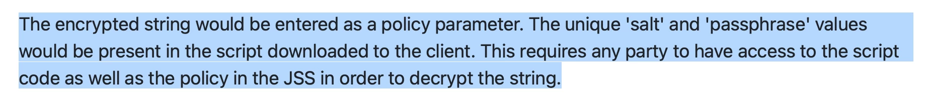

I have a function in my script using the encrypted strings found here;
https://github.com/brysontyrrell/EncryptedStrings

Only the salt and passphrase are local, encrypted string is stored in the policy.
You may be right about best practise but at least it should make you feel less dirty

Arguments configured in the policy are also available on the local Mac, just in a different place. You can see them using `ps ax`. The arguments can be viewed without root access, while the script file itself is only readable by root.
Using encrypted arguments solves a few problems; it is much more secure than passing UNencrypted arguments, and it allows you to hide the information from other Jamf admins who have access to only scripts (which are global) or only policies (which are site-based). These are legitimate use cases, and I don't mean to suggest that the EncryptedStrings technique is invalid. Just be aware that it does not effectively hide anything from the end user if they are a local admin with sudo rights.
