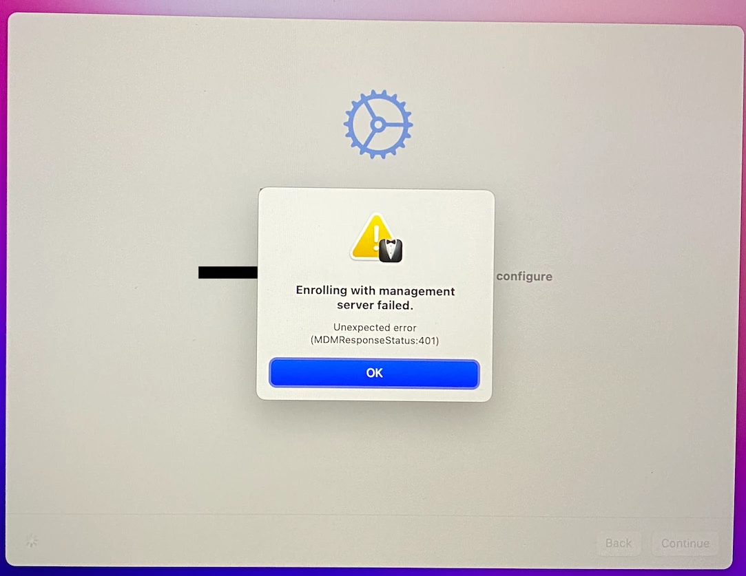

Hi,
I'm using Jamf School and ran into the following problem:
Upon installing macOs (Macbook Pro M1), I am receiving an error:
Enrolling with management server failed
Unexpected error
MDMResponseStatus: 401
I have tried to move device to trash or unmanage it, but nothing works. If I wipe macbook and try again - problem happens again.

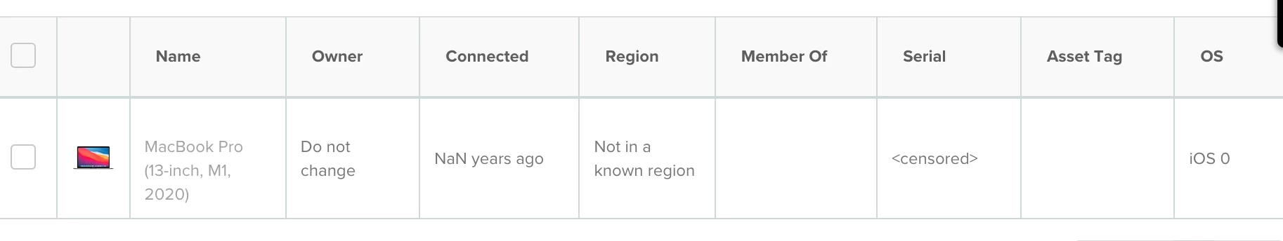

This is how the macbook shows in Jamf School:
Anyone can help?

I believe you can ignore how it shows up in Jamf School. If you catch it early enough, devices getting added will always look funny with things like broken icon image, incorrect models, etc.
As for the error, see Apple's documentation here:
An HTTP 401 Unauthorized error indicates one of the following:
  • Invalid consumer key
  • Invalid or expired token
  • Invalid signature
  • Invalid or already-used nonce
We have had this error before from devices sitting too long, resulting in expired tokens. Wiping the device corrected it, so you should be able to rule out expired tokens.
I'm not an expert in this by any means, so hopefully this at least helped point you in the right direction.

  • Aug 4, 2022 1:46 PM UTC
I did a few things to resolve this issue:
  • delete the Computer Record
  • Created a new PreStage and made sure there were no Certificate settings with Anchor Certificates
  • then on the Macbook Pro, I had to go to Disk Utility and erase the drive, and reinstall the macOS, not once but twice. (just restarted the MacBook Pro setup did not resolve the issue, had to wipe the Macintosh HD)
then it went through
  • Oct 3, 2023 3:52 PM UTC
I was able to fix this with no computer wipe. Here are the steps I followed with Jamf Support:
  1. Confirm the device is in our Apple Business/School Manager and assigned to our Jamf Server
  2. Navigate to the Prestage Enrollment section within Jamf
    • Click on the Prestage Enviornment (we only have one)
  3. Find the computer by serial number > Noted that it was not checked as assigned.
  4. Checked the box next to the computer.
  5. Had the client restart the computer and try again.
