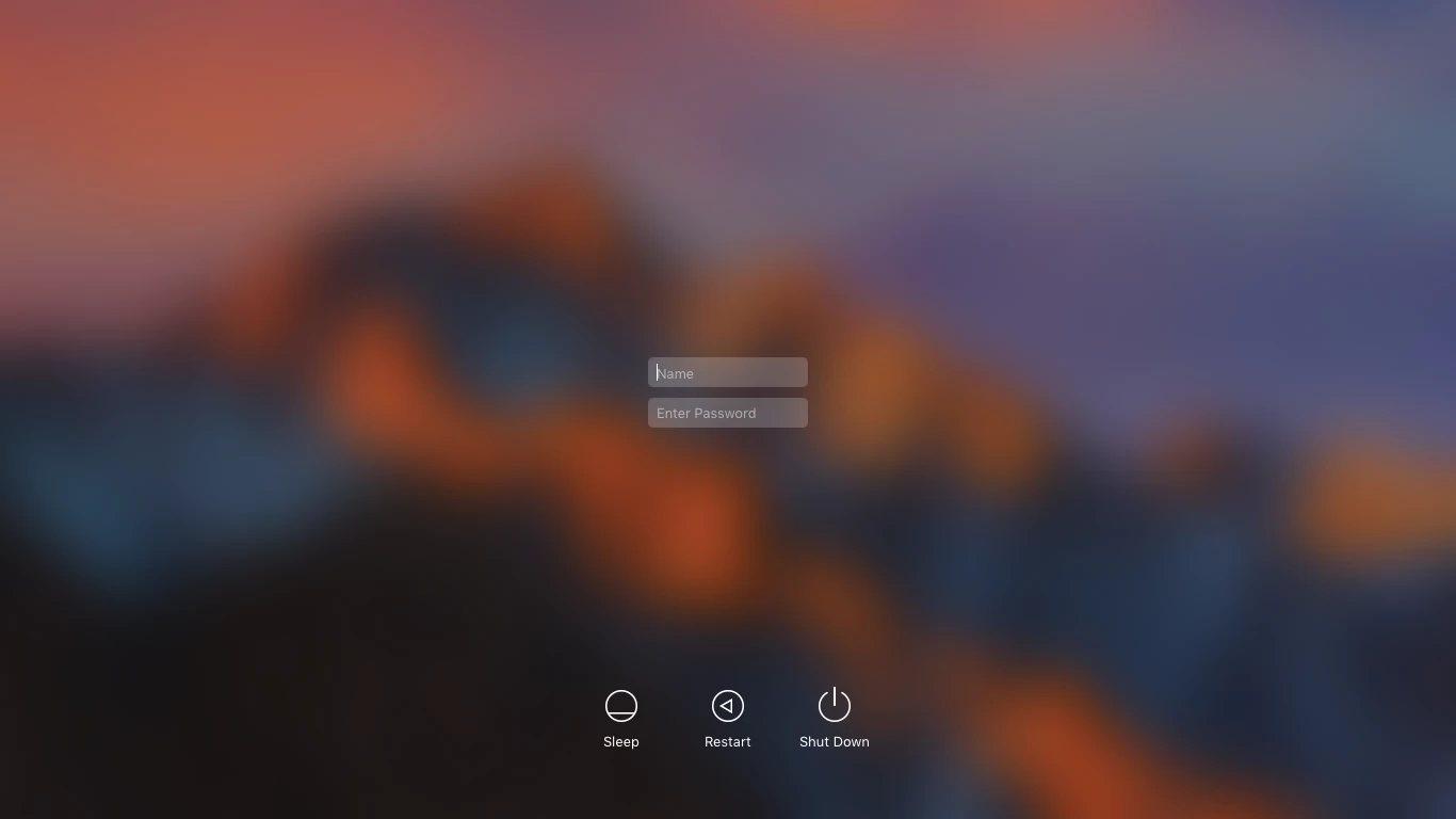

I have a few Macs that I'm testing the new 10.12.1 Sierra update on (build 16B2555).
After the 10.12.1 update was installed, the Macs are longer show any of the usual data in the menu bar of the Login Window (top right corner). No clock or Wi-fi are shown (including the custom hostname, IP, OS version/build etc).
I have a JAMF Login Window Configuration Profile (which I thought may be related), but I removed/excluded it on some of my 10.12.1 Macs and the problem did not get resolved - The OS X menu bar is still missing at the Login Window.
Has anyone noticed this in 10.12.1?
Best answer by dstranathan
Issue is resolved in macOS 10.12.2 (16C67).

It's been there for years (maybe every version of Mac OS X actually). By default it shows the OS X clock. There are cutomizations that can be made to allow it to toggle between other attributes like hostname, IP, etc. These settings live in /Library/Preferences/com.apple.loginwindow.plist I think. I edited my inital post to clarify.

We use the following to display the host name on login screen
defaults write /Library/Preferences/com.apple.loginwindow AdminHostInfo HostName
I updated my Mac to 10.12.1 this morning and ran the above. Logged out and I was able to view the appropriate info by clicking on the time (Name, OS Version & IP Address) It did take about 5 seconds for the icons and text to appear once I logged out.

I just checked my 10.12.1 test Macs and all of them have the correct preferences configured.
testMac1:~ admin$ /usr/bin/defaults read /Library/Preferences/com.apple.loginwindow AdminHostInfo
HostName
In case these was voodoo involved, I re-ran the defaults command and rebooted. No change.
I can reproduce this issue 100% on any 10.12.0 Mac that I update to 10.12.1 via SUS.

My experience with this has been that the info comes back once I select a user to log in as. Then I can click the clock to see the additional info as previously worked. Can anyone confirm if that works for them? At the login window, select an account to bring up the password field and see if the system status area comes back.
More info, I can confirm what everyone else is seeing if the login window is set to name and password fields. If you set it to show users, then you can get the status back by selecting a user. Since the functionality is still there, definitely seems like a bug, not a decision to remove it. File those Radars!

@ehemmete I dont show a list of user accounts on my login winow. I force users to provide a both a user name and a password.
Edit: I modified my login window settings to "Show a list of users" per your example. You are correct - If I select a user account, then the menu bar items reappear. But as soon as I toggle the login window settings back to "Show user name and password" the issue returns. Thanks for this observation. Definitely a bug.
Even my family's Macs at home (non-managed, plain 'ol consumer Apple iMacs and MacBook Airs) are missing the login window data.

+1 seeing this issue on 10.12.1 only - Our 10.9 (glad to be getting rid soon), 10.10 and 10.11 clients are showing the info properly. We manage this setting with the Login Window configuration profile payload.

I received confirmation that it will be fixed in a forthcoming update.
dstranathan
Forum|alt.badge.img+19
  • December 13, 2016
