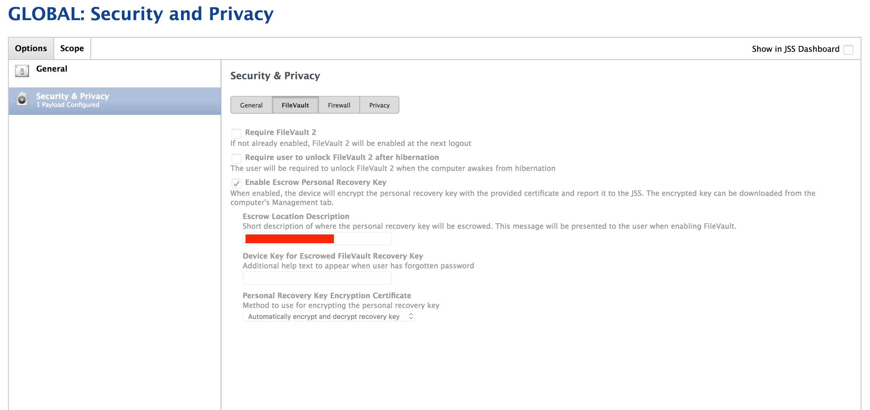

Has anyone found documentation for the new "Enable Escrow Personal Recovery Key" option in JSS 9.101.0 in order to support Recovery Key escrow in macOS 10.13 High Sierra? It looks like Jamf hasn't updated the documentation to report best practices for the "Escrow Location Description" or "Device Key for Escrowed FileVault Recovery Key" variables:

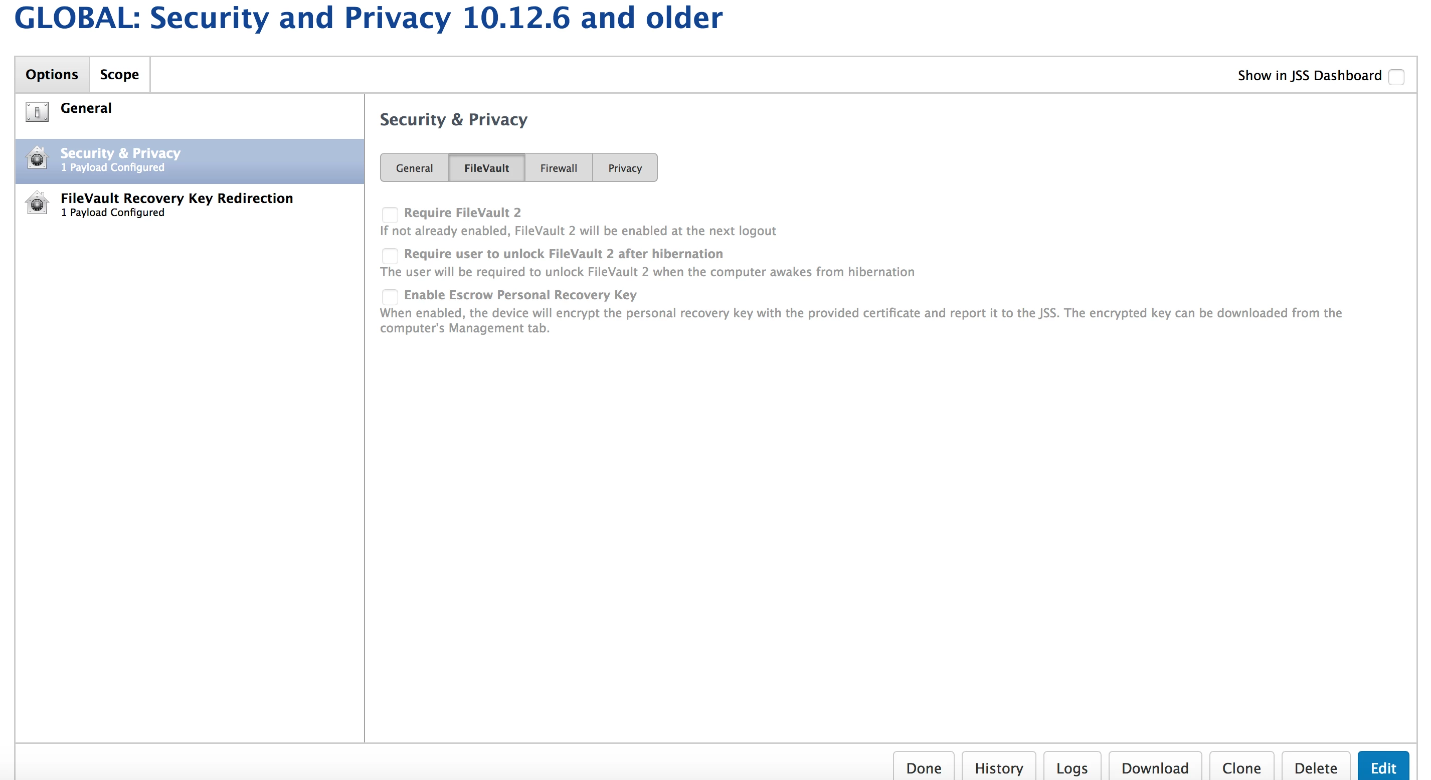

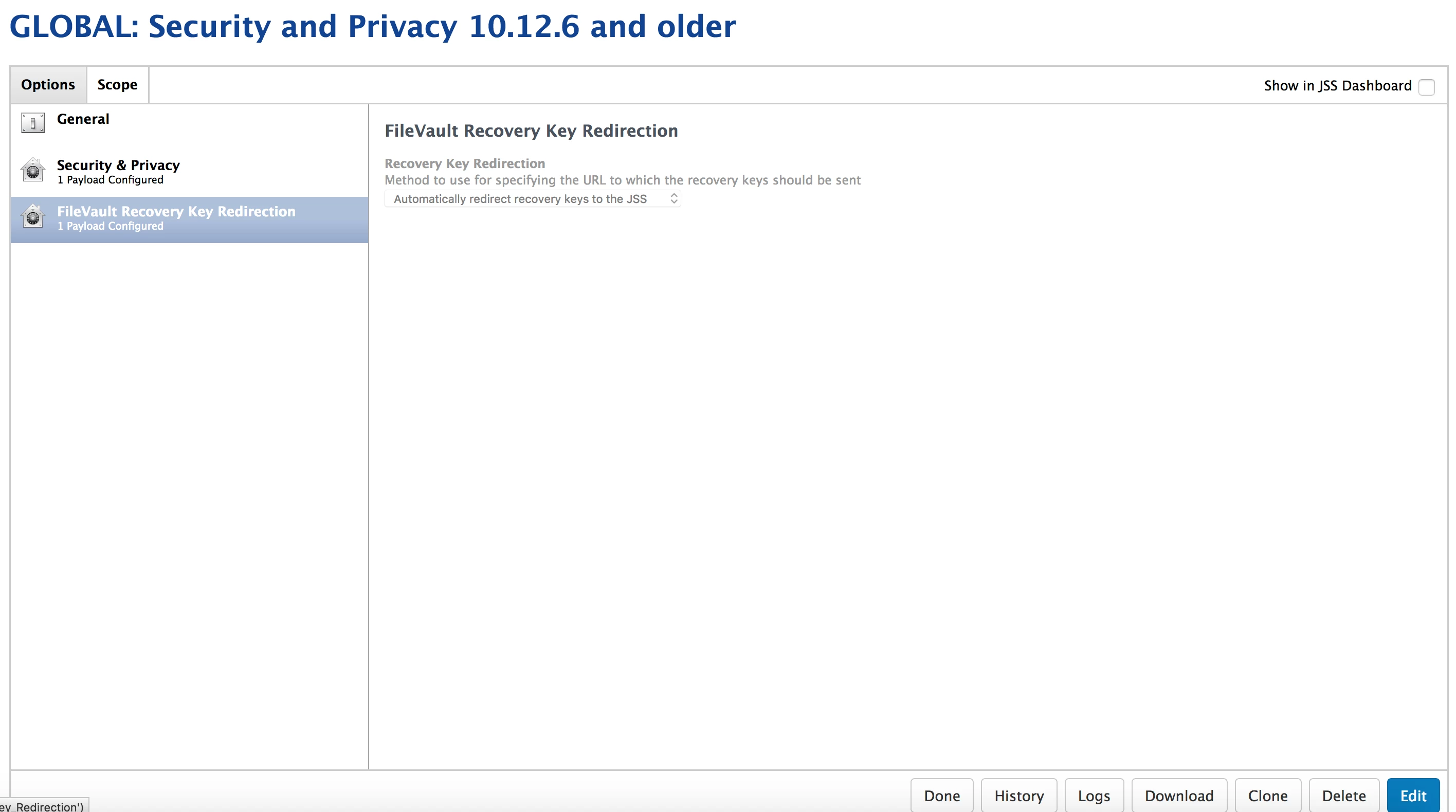

You will need at least 2 configuration profiles one for 10.12.6 and older and one for 10.13 and newer.
Make sure they don't overlap in their scoping.

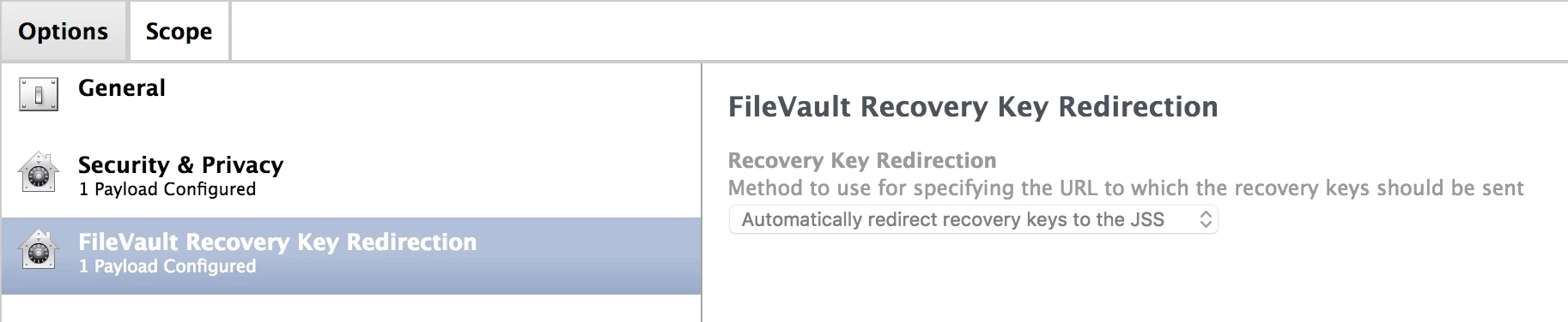

For 10.12.6 and older you only need the FileVault Recovery Key Redirection: Automatically Redirect Recovery Keys to the JSS
I decided to add my Security and Privacy Settings in the Same config profile for 10.12.6 and older but this is not necessary.
Make sure you don't set any of the filevault settings in this payload.

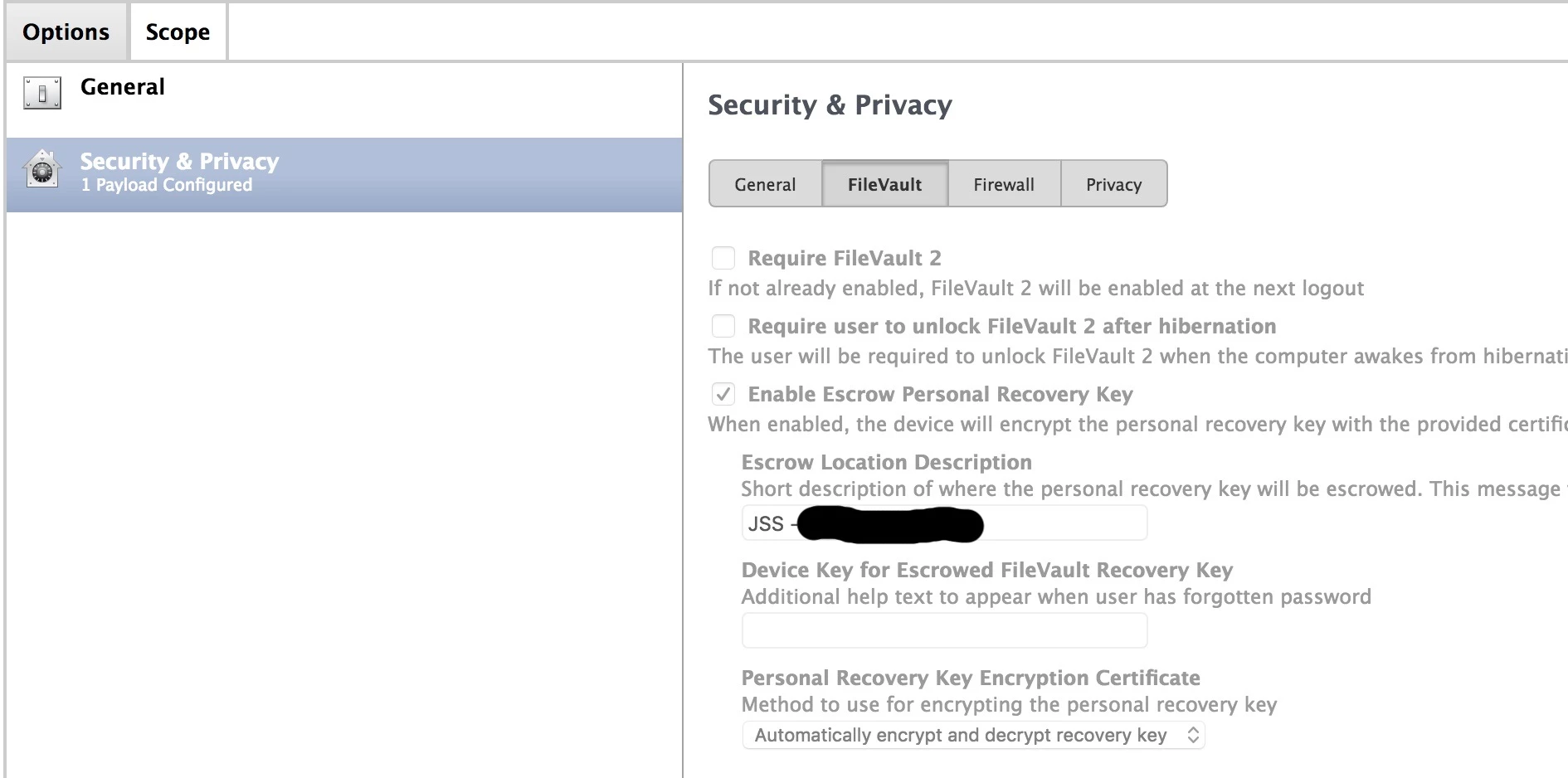

For 10.13 and newer you only need to set the Security and Privacy Settings
Tick Enable Escrow Personal Key Recovery
Under the Escrow Location Description put some information that is friendly to the end user they will see this in System preferences when they try to enable Filevault. I put the hostname of my JSS as it has my company domain in it.
For Device Key leave that blank and it will use the systems Serial Number.
For More info check out the 9.101 Release notes and Config Profile changes.
http://docs.jamf.com/9.101.0/casper-suite/release-notes/What%27s_New_in_This_Release.html

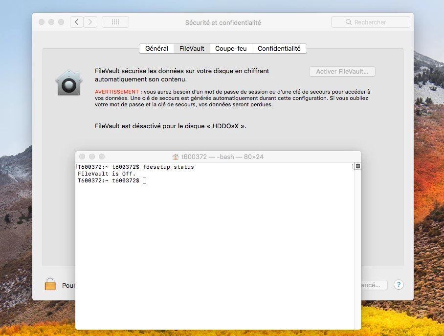

I did the test on a Mac reinstalled clean with High Sierra.
I did follow your procedure, I see the profile configuration on the Mac but Filevault does not activate even after several restart.

Hi @dan.snelson, here is the result I take on my Mac after several Recon and reboot "FileVault is Off".
With OSx 10.12 the encryption started automatically at the next reboot, but this is not the case with OSx 10.13.
Is there still a rule missing?

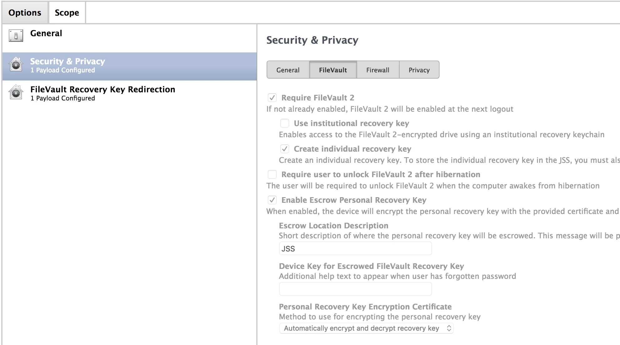

@dan.snelson The only policy that relates to FileVault and the creation of a user who is allowed in FileVault so that the administrator can connect to recover files if the user loses his password.
@brock.walters If I understand correctly, we can leave the 2 Payloads (Security & Privacy and FileVault Recovery Key Redirection) for all OSx versions but also activate the Enable Escrow Personal Recovery Key?
I made a printscreen to better understand

Hi. Once the configuration profile containing the Security & Privacy > Enable Escrow Personal Recovery Key (as in the screenshot provided for macOS 10.13 devices) is installed on the Mac (visible in the Profiles System Preferences), is there any action to trigger the Filevault encryption ? On a test device, we have the configuration profile successfully installed but no FileVault encryption is at least suggested to the logged-in user. Thank you for any advice ! Franck.
