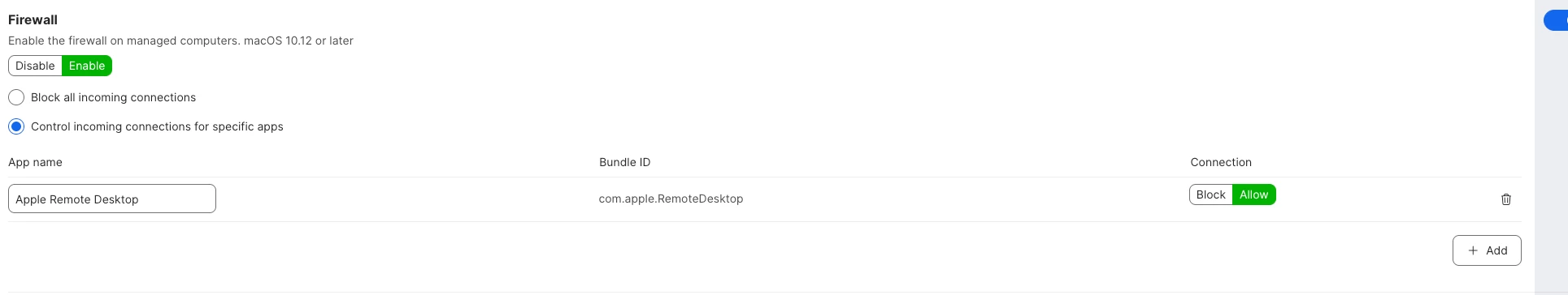

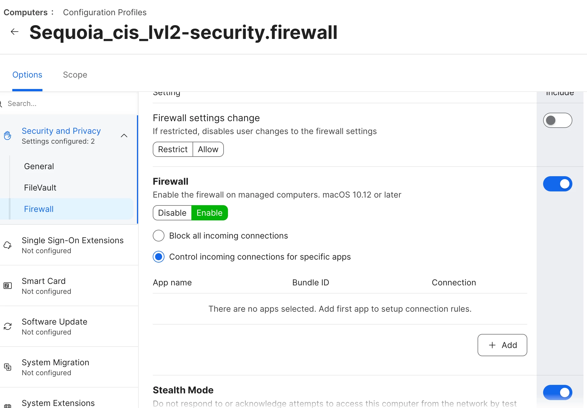

I noticed our updated firewall config as cut of the ablity to screenshare using vnc I think I just need add allow com.apple.ScreenSharing under this section. Does anyone have the bundle ID for com.apple.ScreenSharing or now how to find it.
I would normal run something simliar to this https://www.hexnode.com/mobile-device-management/help/how-to-find-the-bundle-id-of-an-application-on-mac/ but only seem to work for apps. I dont think it would work as its not an app.

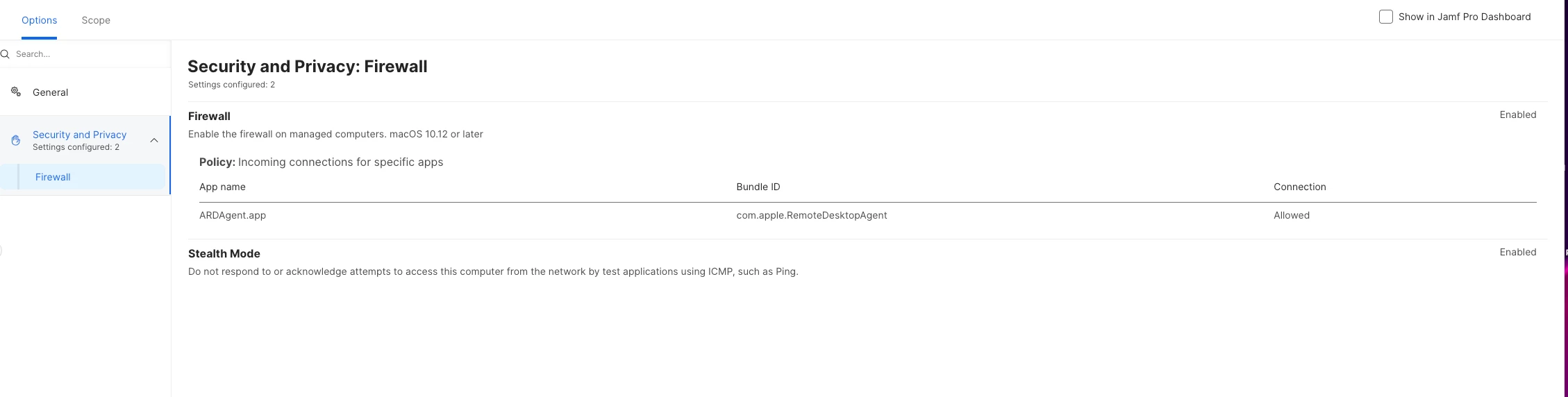

Looks like Im stll missing some services for this,
Looking at my old firewall profile these where all enable I assuming by a seprate profile as there not in the firewall profile.
Think there other services missing from this list just not sure what.

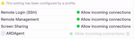

/usr/libexec/ApplicationFirewall/socketfilterfw --listapps ALF: total number of apps = 2 2 : /System/Library/CoreServices/RemoteManagement/ARDAgent.app ( Allow incoming connections )
Just getting the above @Valcovish so its appear to need ARDagent.app which needs to be allowed
 This is all that is listed on machine that is working for vnc but still doesnt seem to work. I wondered If I have other issues as if I remove the firewall I still cant connect. Need to have look in the lab tomorrow so what happning on the machine.

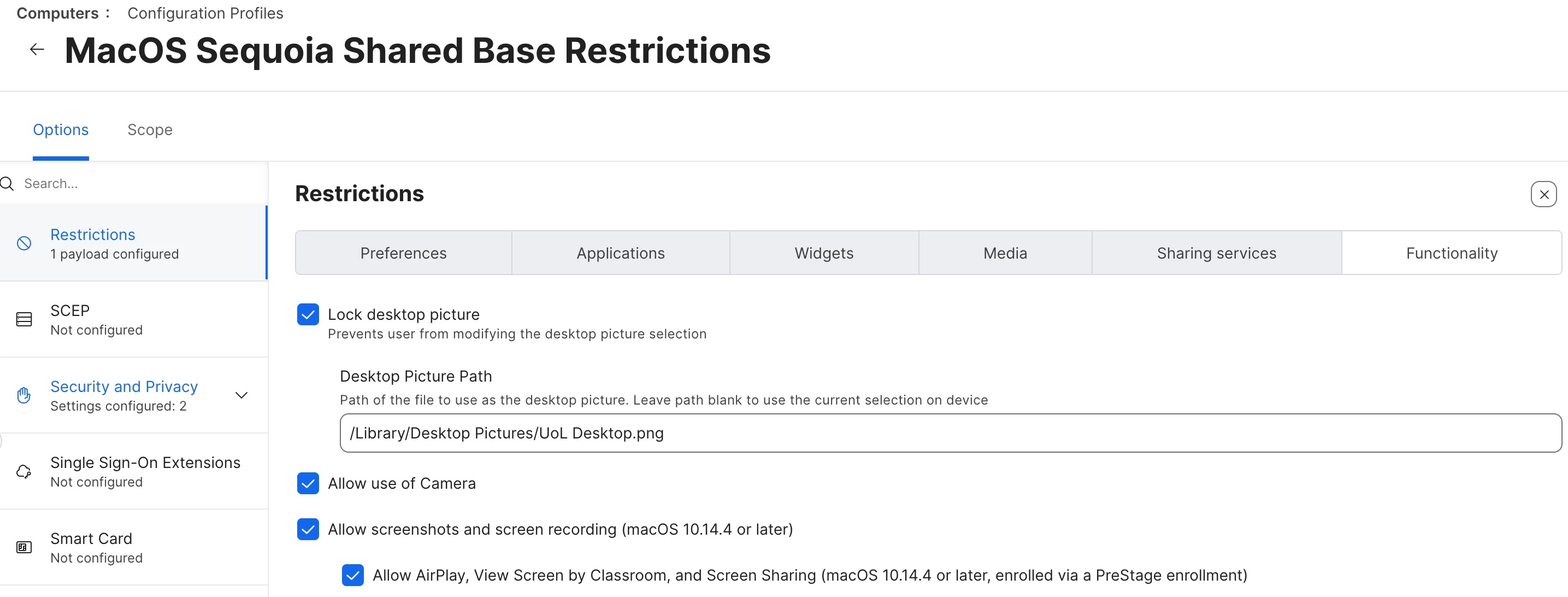

  • Mar 12, 2025 9:16 AM UTC
@Valcovish @jamf-42
I was missing this ticket box  which is part of my base restirctions.

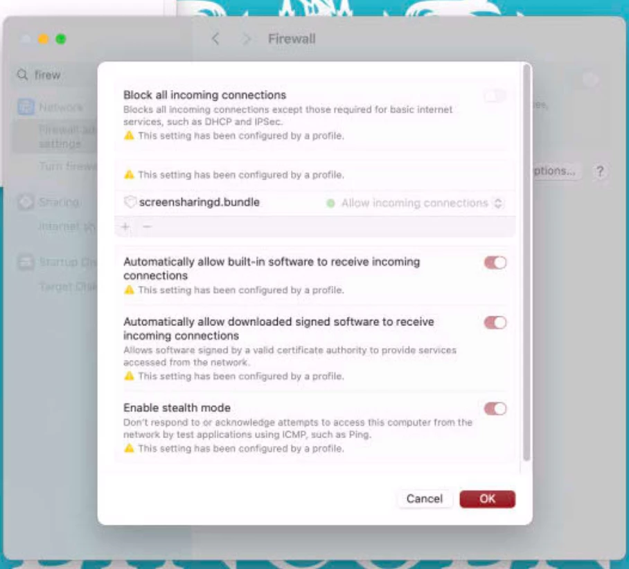

This adds in the following into my firewall rules
 While I havent alllowed it here it does seem to work, but only if control Incoming connections for specific apps is set. I assume because screensharingd.bundle is part of some app for screen sharing.
Many thanks for you assistance if figuring this out @Valcovish
