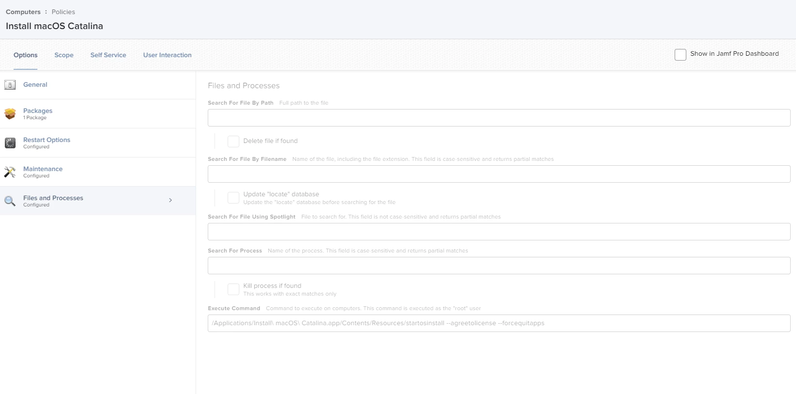

Hello, I'm working on upgrading couple of mac to Catalina but nothing I do is working I have already uploaded the .pkg file to jamf pro server but when I run this install command nothing happens.
Here is my command on the files and process tab.
/Applications/Install macOS Catalina.app/Contents/Resources/startosinstall --agreetolicense --forcequitapps
Any help will be appreciated

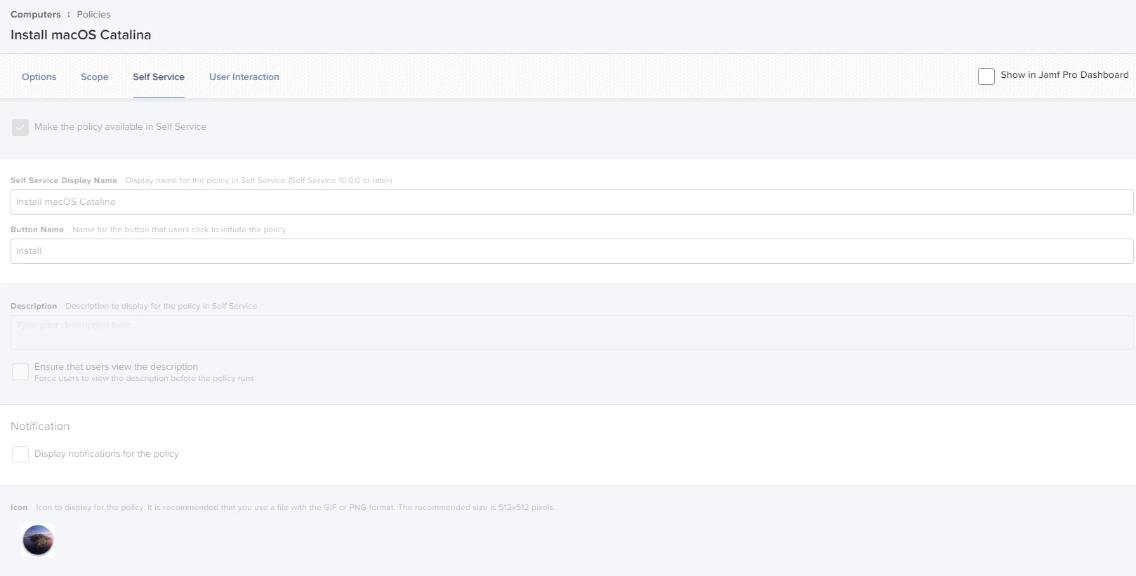

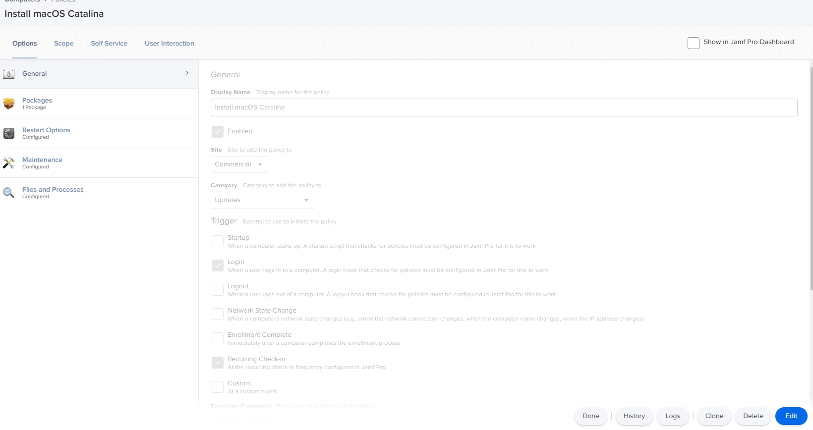

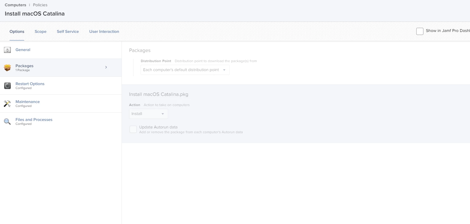

Yes I ran the command on a spare machine and everything attaching the screen shot
Thank you for the help I'm super new on this
mm2270
  • February 26, 2020
Ok, so from your screenshots, what you have is a single policy that "installs" the "Install macOS Catalina.app" file to the Mac, then runs the startosinstall command in the Execute Command field.

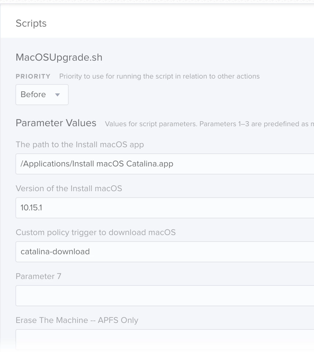

I use this to do Self Service upgrades. It looks for the installer on the machine, and if it doesn't find it. Then it tries to download from a Jamf policy you make. It has step by step instructions. https://github.com/kc9wwh/macOSUpgrade
summoner2100
  • February 27, 2020
and that's the section of my policy that tells it the Catalina installer options for the script. (the custom trigger is just a policy set to all machines that will drop Catalina installer into Applications as per the Github link instructions). I've scoped it to all machines, as it's a custom trigger that will only run if they get the upgrade script scoped to their self service. Just ignore parameter 8, I'm testing an erase option to the script and I haven't made sure it works yet.)
