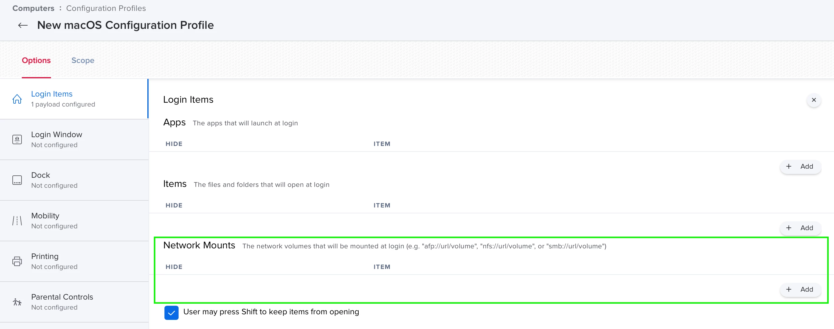

Why not use the Login Items payload in a configuration profile? I have done this on AD bound Macs and it worked really well. The logged in user is irrelevant. All that matters is that they have permissions to access the shares that we define in the profile.

First of all thanks for the reply of you all. @howie_isaacks I have tried to map a network mount using macOS config profie. However, it mapping the whole domain to students. Not sure why. It doesn't map the particular folder for some reason.

@Mudalige I didn't know you needed a full path to a folder. I guess instructing users how to find the folder they need is not doable at least until you get this figured out? My clients have mostly abandoned traditional file servers, and moved to a service called Egnyte which allows us to offer both a private folder for each user and a company wide file share based on the users' individual and group permissions.
  • September 10, 2020
@howie_isaacks My path for the student share is like on AD domainnameHomeStudentsYear_Xusername
If I translate this to mac mapping version
Would this be smb://domainname/home/Students/Year_X/%username%
Please correct me if I'm wrong
